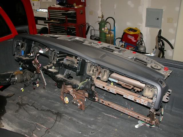

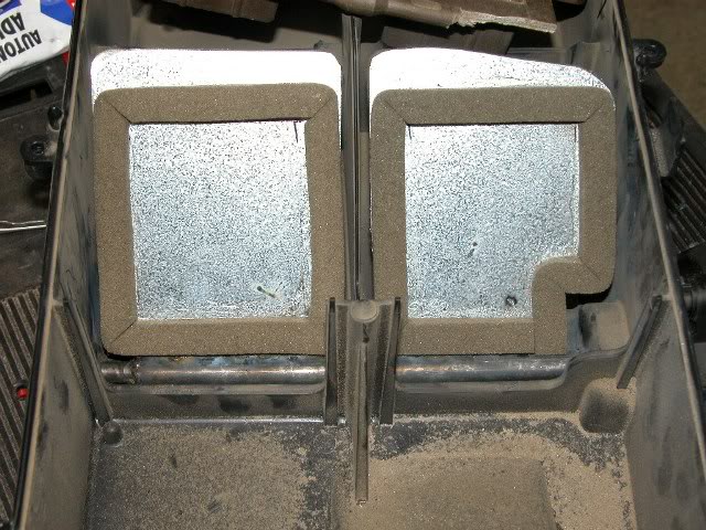

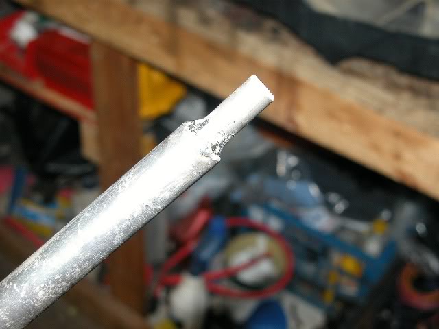

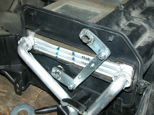

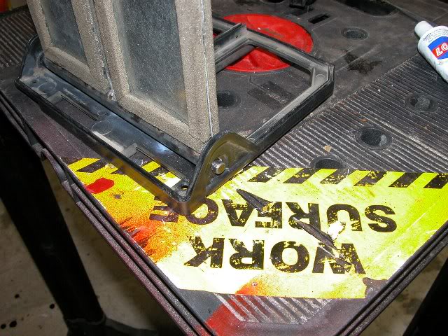

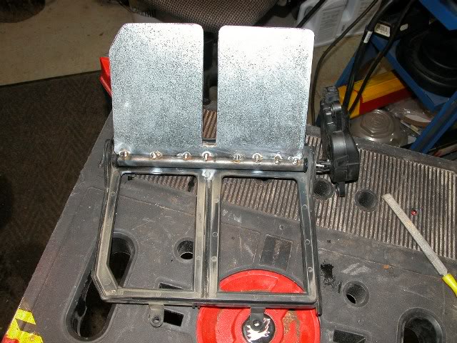

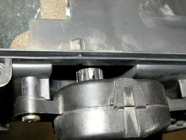

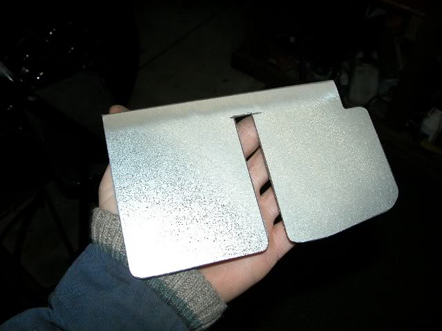

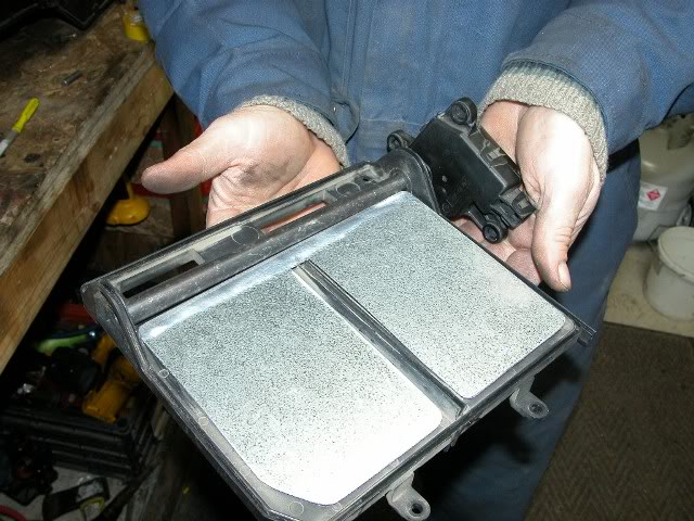

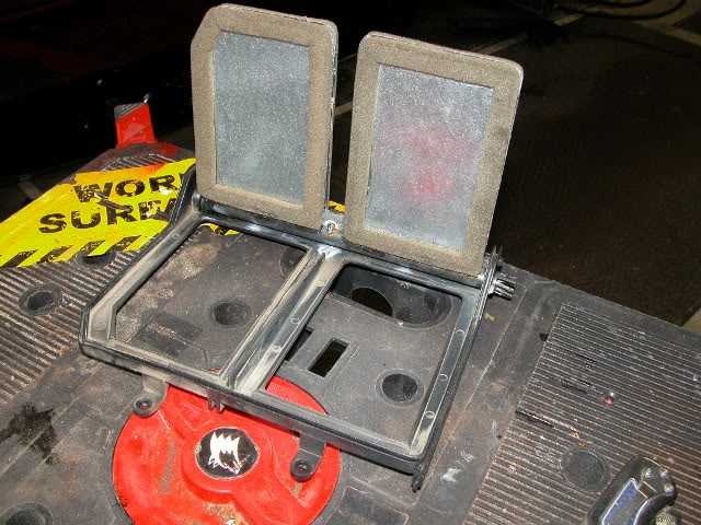

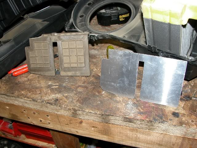

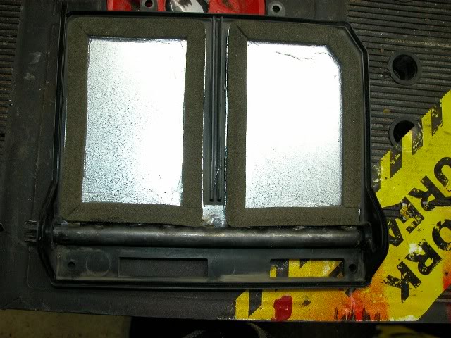

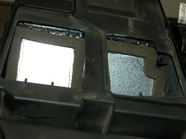

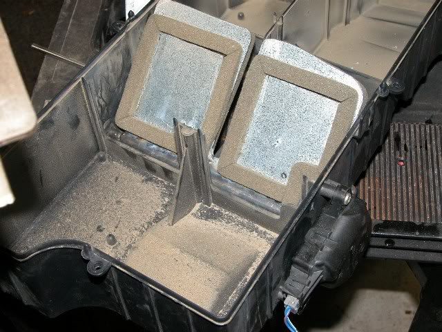

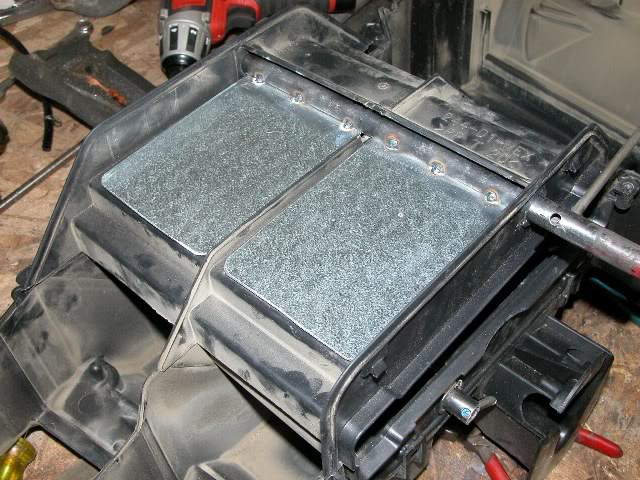

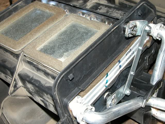

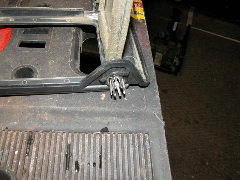

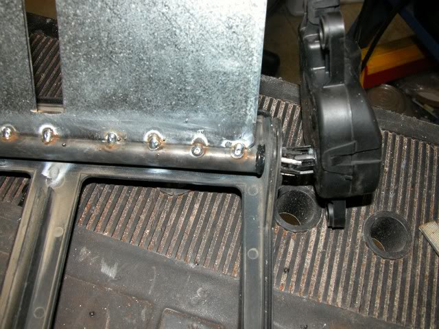

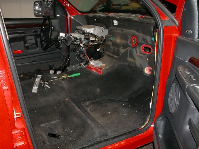

This is my solution for the problem

Old Dec 1, 2010 | 07:00 AM

OMG....screw that. I'll have a dealer tear it apart that far down. That way I can complain to him about every little squeek and rattle afterwards.
So far mines fine without the recirc door. It's been in the 20's and 80's. Works about the same.
