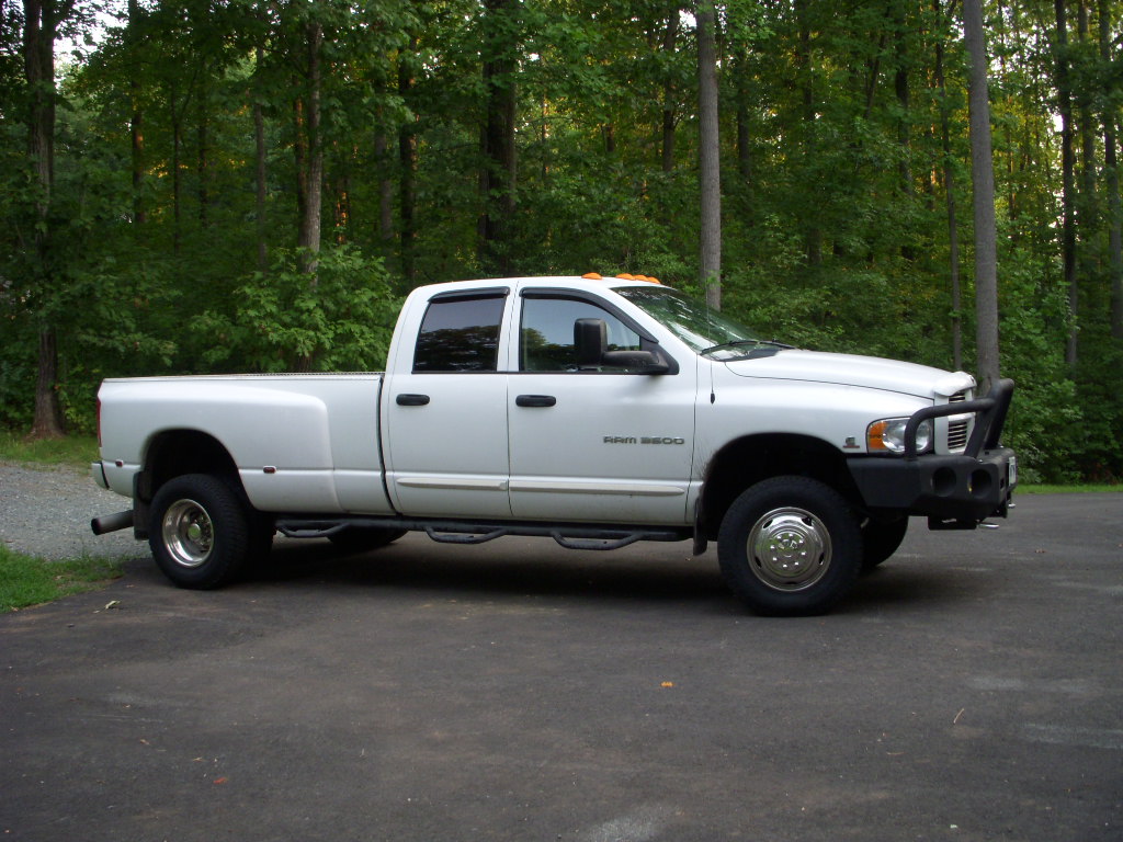

I recently bought a gooseneck 4-horse stock trailer. When I hitched it up to my truck, it became apparent that this trailer wasn't built with a 2005 Dodge 3500 DRW in mind. I just barely have 5-6" between the tailgate/bed corners and the goosneck frame rails. The trailer sits way high in front and way low in back. Nice for loading horses, but lousy for hauling them.
Anyway, in an effort to reduce the chance of getting gooseneck rash all over the bed of my truck, I started looking for ways to either raise the trailer or lower my truck suspension, or both. I found that the rear leaf springs on my truck have two 1/2" pads between the spring packs and the spring seats (see photo). My truck also has a 2" leveling kit in front. I think that if I removed the two pads, and got larger diameter trailer tires, I might level the trailer out enough to be ok and reduce the chances of gooseneck rash on my truck.

I am considering removing the front leveling lift (although I love the look) as well as the pads in the rear. Any thoughts as to the effect this will have on my truck, fuel mileage, hauling, etc, would be appreciated.

We did a custom job for a local 06 2wd. Without getting crazy, there is really no way to lower these trucks much. You can remove the little blocks/pads below the springs and the lower overload, and then you can buy lowering shackles. I think with the shackles, you can lose another inch. You should be able to go about 3" total. The customer's truck ended up getting custom spring hangers up front and the frame C-notched to keep the axle from contacting the frame. Overall, I think it came down 8-9".

I thought I had a great idea of removing the bottom OLs on my 03 to improve the ride but I had to put them back in cuz the bag were getting hammered hard - smashed. I cut the ends off the OLs before putting them back in. Maybe the 05 is built different but my 03 needed all the travel it had so the axle didn't bottom out on the bags. Craig
I moved those blocks to the top of the spring pack on my 03 and it gained about 1 1/2 at the tailgate, might be different from on an '05. Not difficult to do, but suspension parts tend to be rusty and beat up, need a good impact with lots of air pressure...
I'm thinking that if I do that and just leave the front leveling lift, I might gain more at the tailgate than if I remove the front lift. Just looking at the truck now, I don't think that would make it low in the rear.
