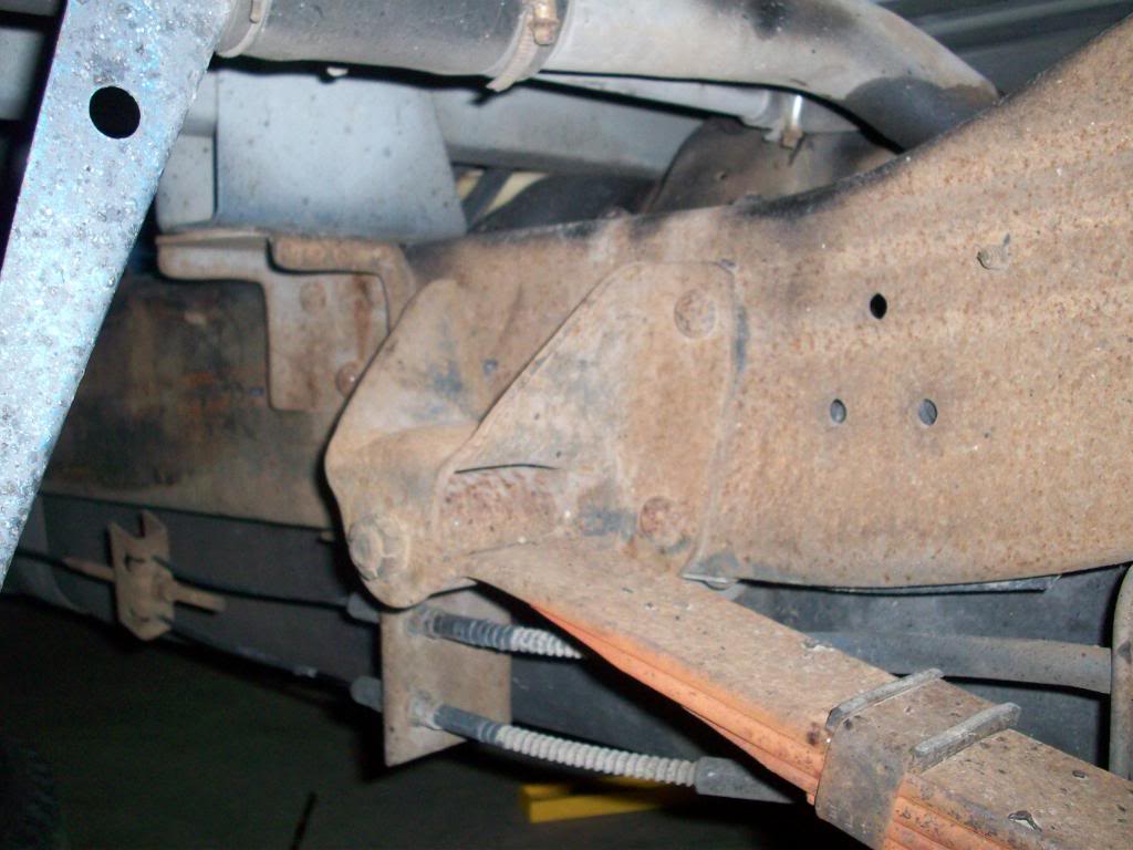

I lowered my first gen 4" in the back by flipping the front leaf spring mount and moving the rear leaf spring mount up 4"
Here is the front mount before
after
the rear mounts before
and after

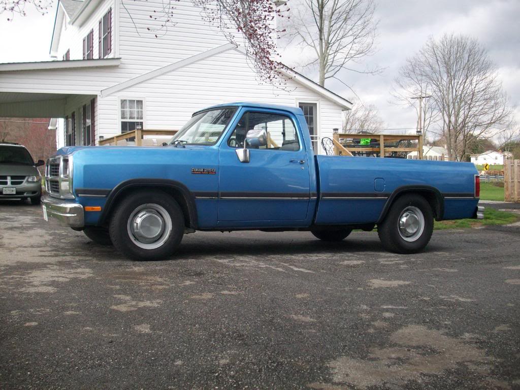

here is a pic of the truck lowered 4" in the rear and 2" in the front
Old Jun 30, 2009 | 01:49 PM
Crossy's son's Avatar
Looks good c12
Good thinking in the back, never would of thought of that.
Did you cut the coils up front or something??
Old Jun 30, 2009 | 01:52 PM
c12h26's Avatar
Posts: 97
From: rising sun, MD
we just heated them with a torch
