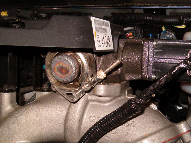

I took the crossover pipe, cut the ends off, TIG Welded plates to make caps, and reinstalled them, along with removing the butterfly from the intake.

Now this is soooooo extreme. all you need to do is make a couple of blocker plates with the gaskets as a template from under where the valve connects to the intake. slide them in and put the bolts back in. Can't even tell they are there and remove in a minute when testing is needed.

Yes, but I had the SS Plate, the TIG, the Rods, and Time!!
