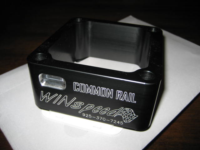

Just call them and order one. Either Brett or Adam will answer.
925-370-7245.
I'll try posting a pic.
Jacob

WINspeed's website is under construction, but they have an Ebay store or like jacob said they are in the yellow pages. Martinez CA

got my delete installed

Looks good, you have the new logo design. Ive got one of the first ones in blue. Smart guy you washed b4 the pics.......Did you notice a little quicker spool and slightly more power at the lower end?
Now you need a nice free flowing filter and tube to the turbo for the full effect of the better flow.
