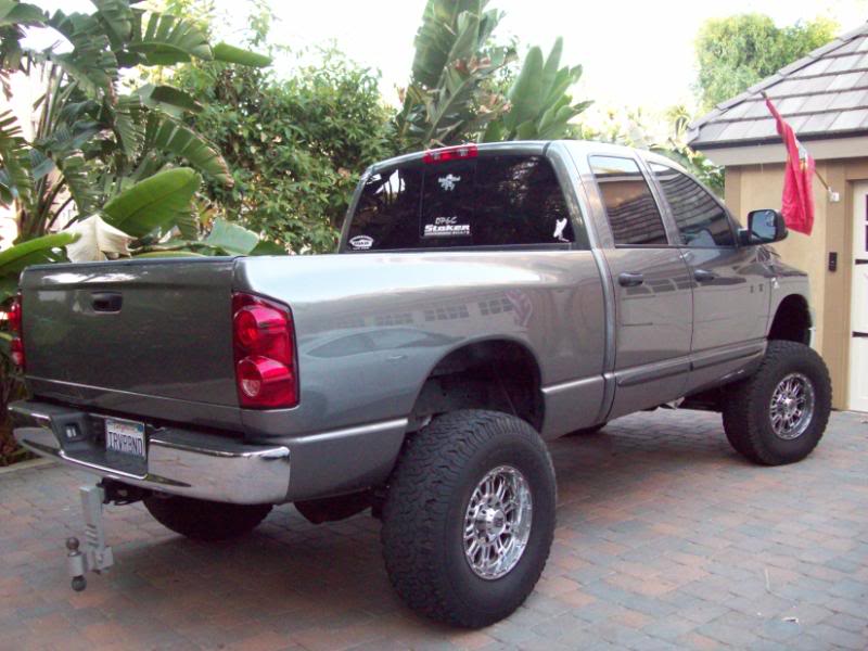

I had my truck lifted and the original lift was a 7" lift that was modified to be a 9" lift. I had quite a few issues that i have been dealing with the last couple years with the lift (the main thing was it rode poorly). I finally had enough and tore the enitre lift off and started over with the new pro-comp "long arm" lift.
I have put about 500 miles on it in the last 2 days and can say I am completely happy with everyhting and it now rides better than it did when it was stock. The only downside is the girlfriends **** wont bounce as much driving down the freeway
Here is what the truck looked like with the old lift. I do miss the height but its much easier to get in and out of now.

Here it is with the new kit.

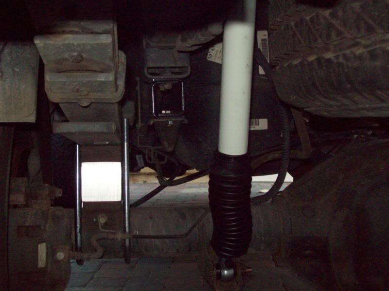

the rear had blocks that looked like **** in my opinion and the fox shocks that no matter how many times I had them worked on they were never right for my truck
The new blocks look much better, as well as the new shocks were are valved for this particular application.
