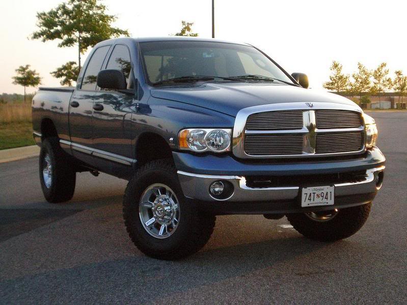

I've done 3 sets by using the link. Not all of us have access to a CNC. i have a mill.
Cutting the caps and grinding the tabs works great too and none have fallen off.
I did this set for Mike. He has since sold the truck, turned out nice.
