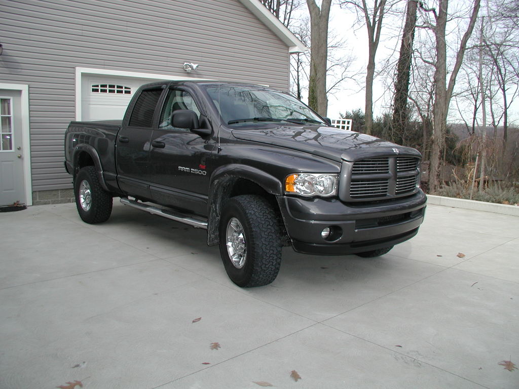

Originally Posted by Fisherguy
Yeah, I've heard of the double nutting thing but Kanucklehead was looking forward to trying to mill that part and who was I to keep him from that?!
Nice looking truck Bee, those BW flares?
Thanks.
Yes they are Bushwacker OE flares.
Used with modified factory splash guards they do a great job of keeping the 315's from throwing mud and stuff all over my truck.
