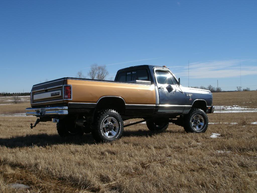

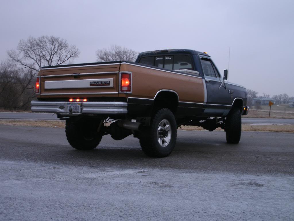

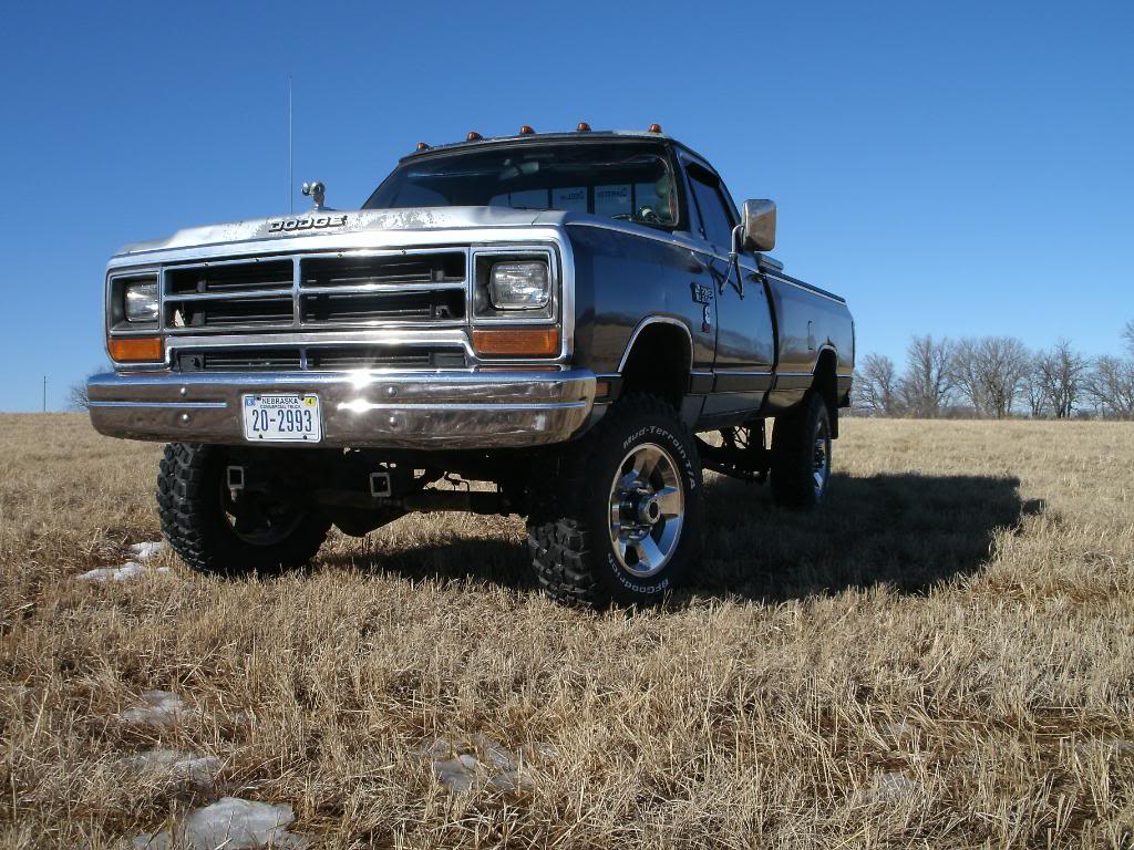

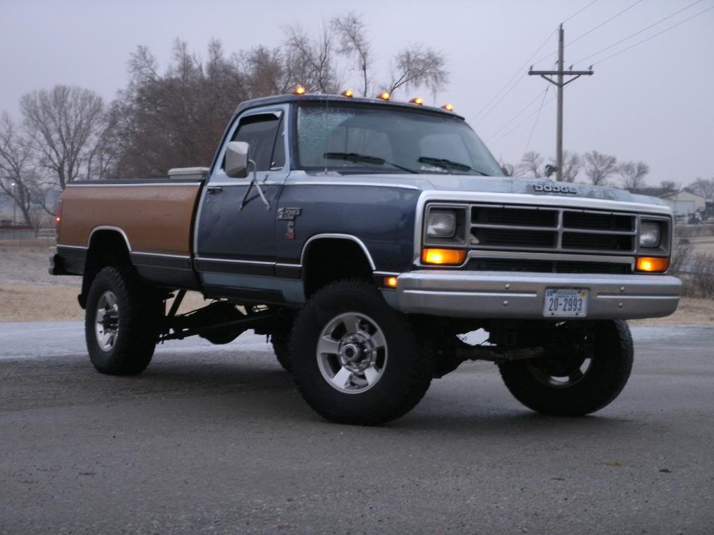

Been thinking about gettin a set of these in the next few weeks.
I know this is a 3rd gen forum but do you think they'd look a bit smallish on my old 1stgen? FWIW the 315/35s only measure 33 with a tape as it is.

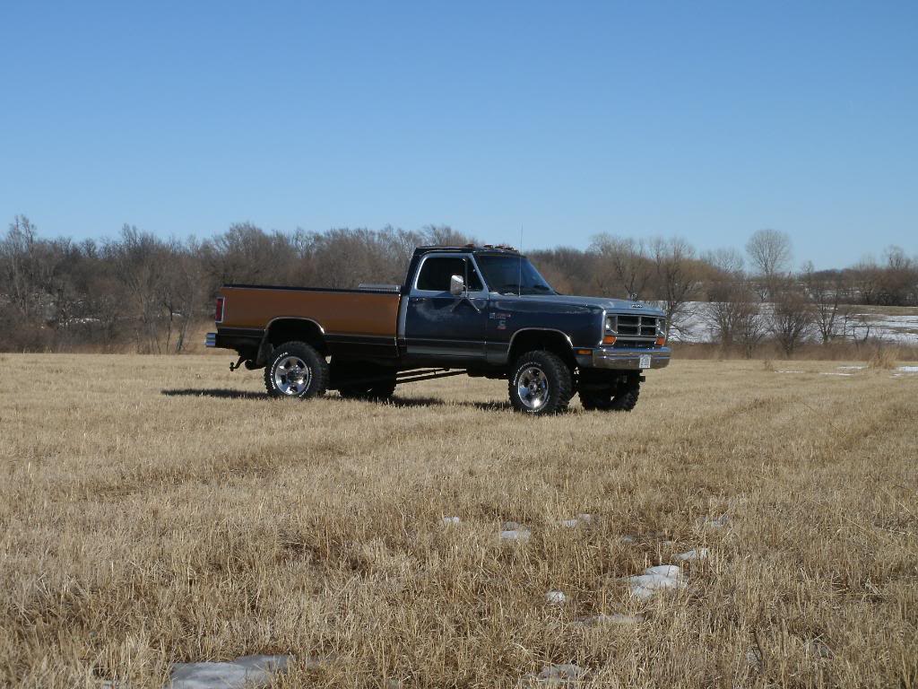

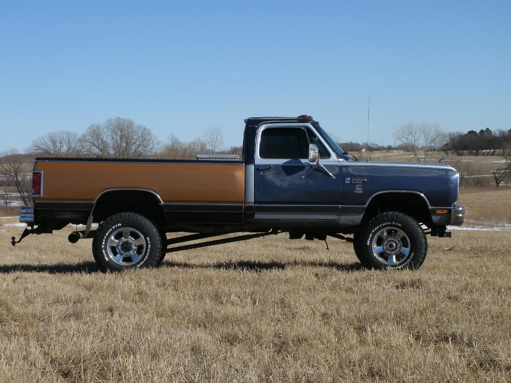

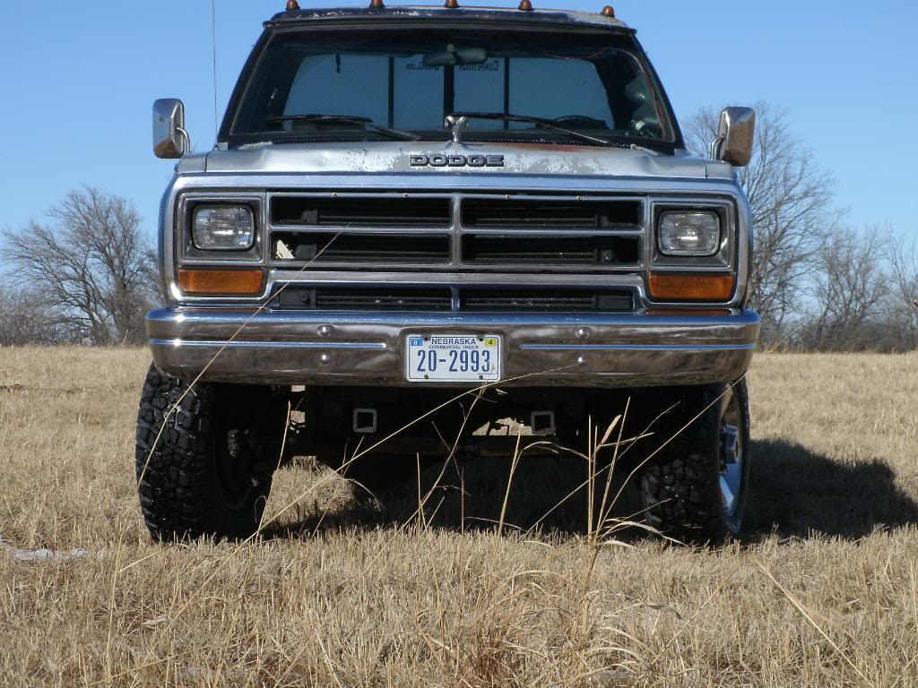

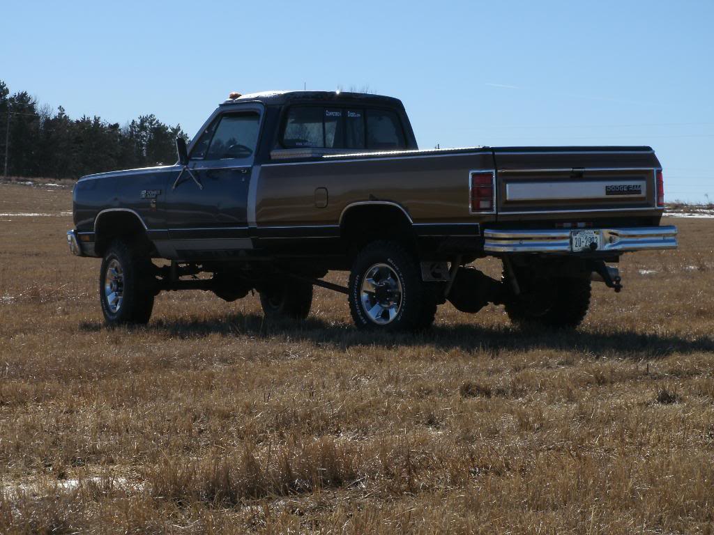

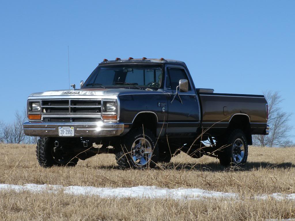

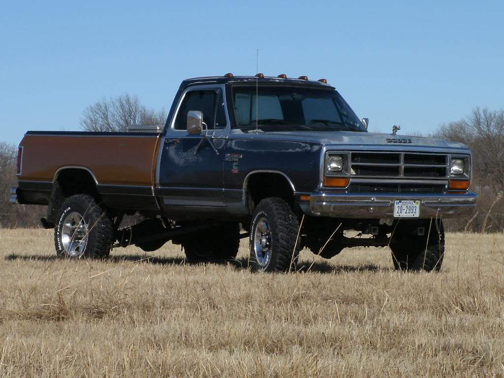

Picked me up a set for the 1stgen.

I think they look just great!
This is the size im gonna run on my '11. No need for a level or spacers suits me just fine.
