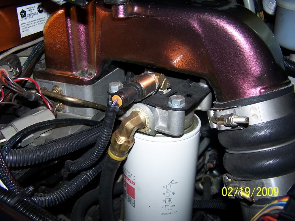

I kept the stock canister filter then run the GDP 2 micron set up. System works great, but I probably will be moving the mounting under the truck because I am really wanting to get twin pumps on this thing!
Old Sep 7, 2009 | 10:48 PM
Snoxracer's Avatar
Posts: 326
From: IOWA
Also you can see that I tapped the filter housing to install my fuel pressure sensor, then I know exactly what is going to the pump.
