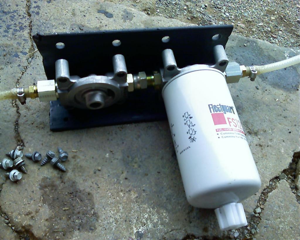

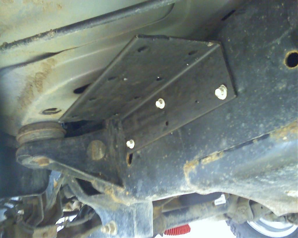

Iam going to be running this one in the picture, I fabbed it all up myself, Iam wondering about the pump iam going to have to put on there a Walbro, or Holly black/Blue, (Iam leaving the stock intake pump) Can i just tie into the wires running to my stock pump along the frame? Iam going to need more pressure to run threw my filters. any suggestions on how to hook this up from any people would help me out greatly.

Bolted right under the drivers door, going to change the big filter so it doesn't hang so low.

that orange filter hangs down there quite a bit!! LOLOL

ya, iam gonna change that filter out with a Cat 8" that ones 11 1/2".
