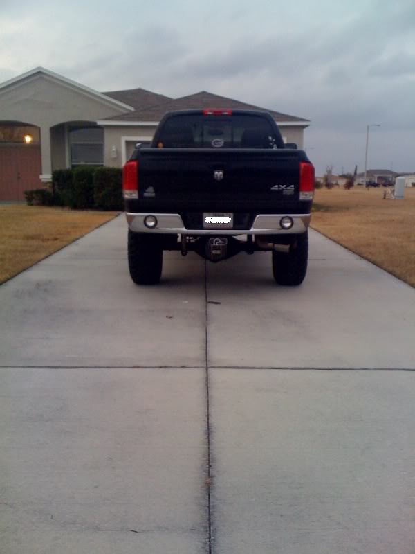

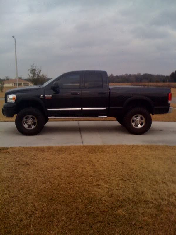

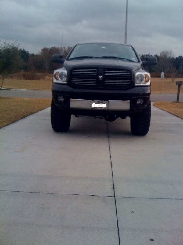

Ok ... as requested ...
Tire diameter - mouted with weight - 35 3/4"
Front height to top center wheel well - 46 1/8"
Front height to rear of wheel well - 24 1/2"
Rear height to top center wheel well - 46 1/2"
Rear height to rear of wheel well - 26 3/4"
And Pictures as requested ...

That's awesome, Thank you very much Mike! That's a great looking rig you got and I really like the recessed lights in the rear bumper!

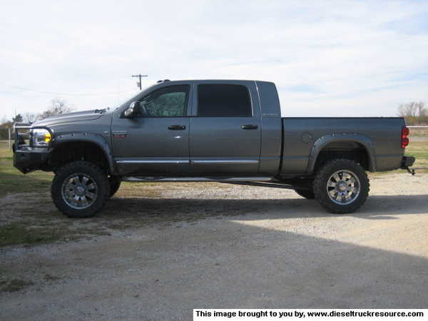

Old Jan 23, 2010 | 09:05 PM
Clane's Avatar
Posts: 342
From: Henderson, NV.
6" Lift
37" Tires
20" Wheels
