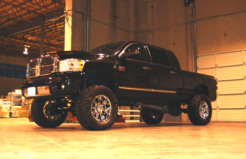

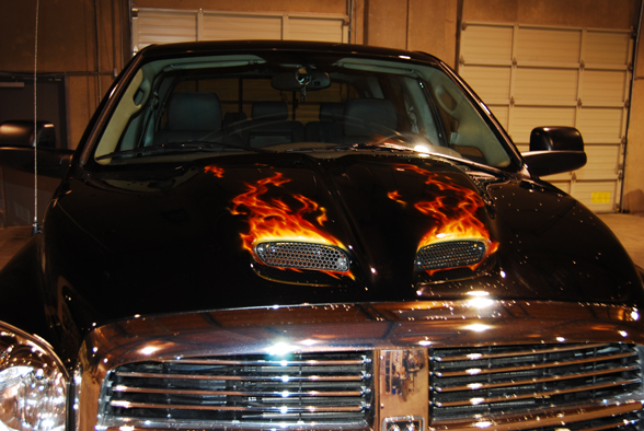

Thats what I thought, really appreciate the thoughts. But with 38's maybe I can go to 456? and still be ok? Did you have the 6.7 with the 6 speed auto? Here are some pics of what I did to the truck.

Sweet. I like that. Go with the 4.56 and the 38's. If you think you went too low (numerically high) with the gears then just go a bit bigger on the tires...
