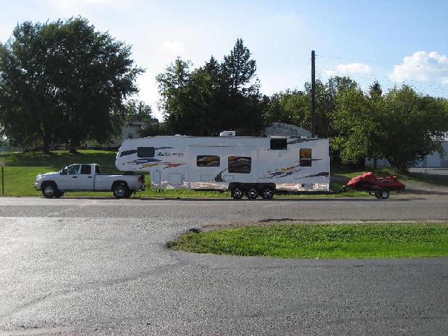

I pull a 40 ft toy hauler all the time with my mega. No problems. this is a pic with my old truck
2500 or 3500?
Thanks for the help and keep the replies coming.
How much does that 40' hauler weigh and how much pin weight?
