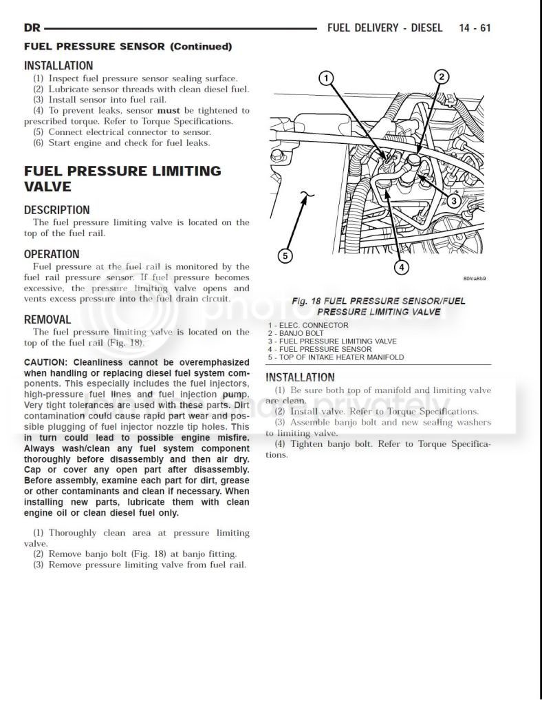

Do you have a FP gauge? What is your low pressure reading?
I'd pull the connector on the rail pressure sensor and clean it, and re-seat it.
http://i943.photobucket.com/albums/a...esssensor1.jpg
http://i943.photobucket.com/albums/a...esssensor2.jpg
