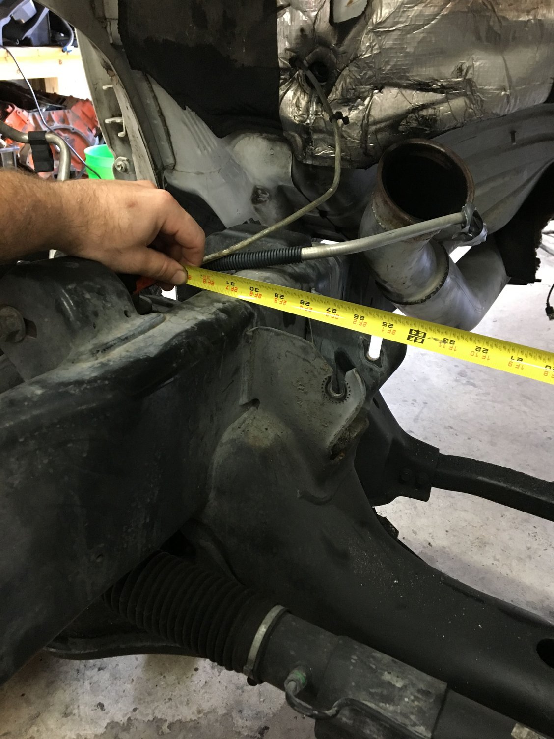

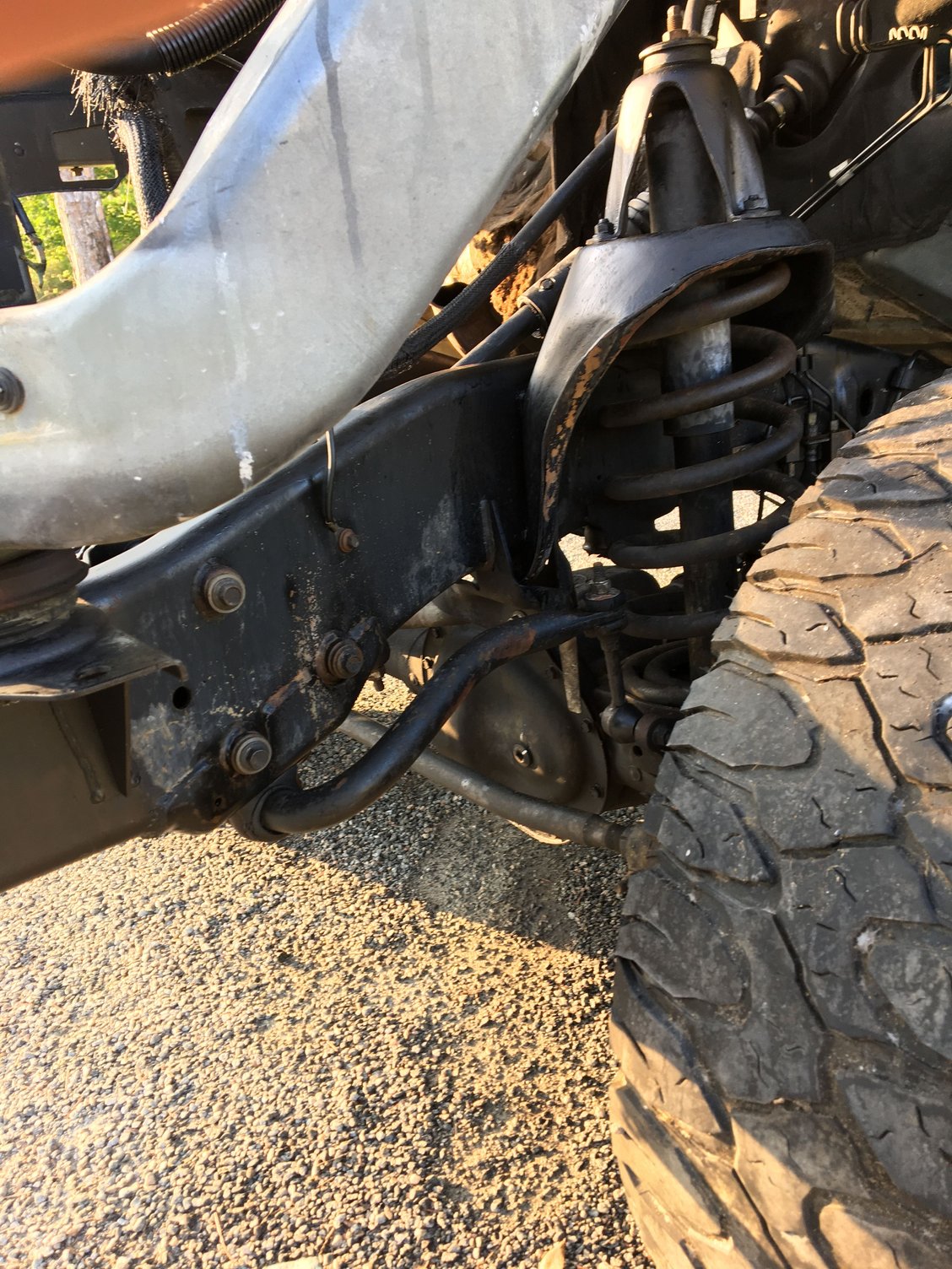

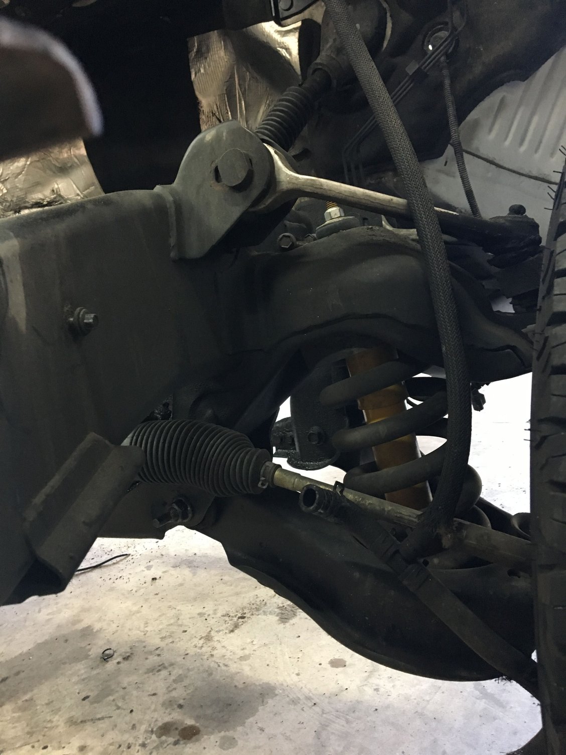

I swapped the engine and g56 from my 05 3500 2wd dually into a 2003 ram 2500 4wd 48re and I took frame pictures, hopefully to qualm the idea of putting a front axle in your 2wd dodge, it’s more then you think.
I did a massive swap in 80 hours or 5 days, alone. So forgive my lack luster pictures, it was day 3 and I had to get home, 2 hours away because I did this on vacation, with no back up vehicle.
This isn’t a swap break down, this is just frame pictures.
I will say this, it’s the engine, tranny, complete dash, engine harness, rear harness, interior harness, headliner, fuel tank, exhaust and fighting with out removing the engine head and oil pan.
Please post around different threads and make comparison pictures to help guys out!

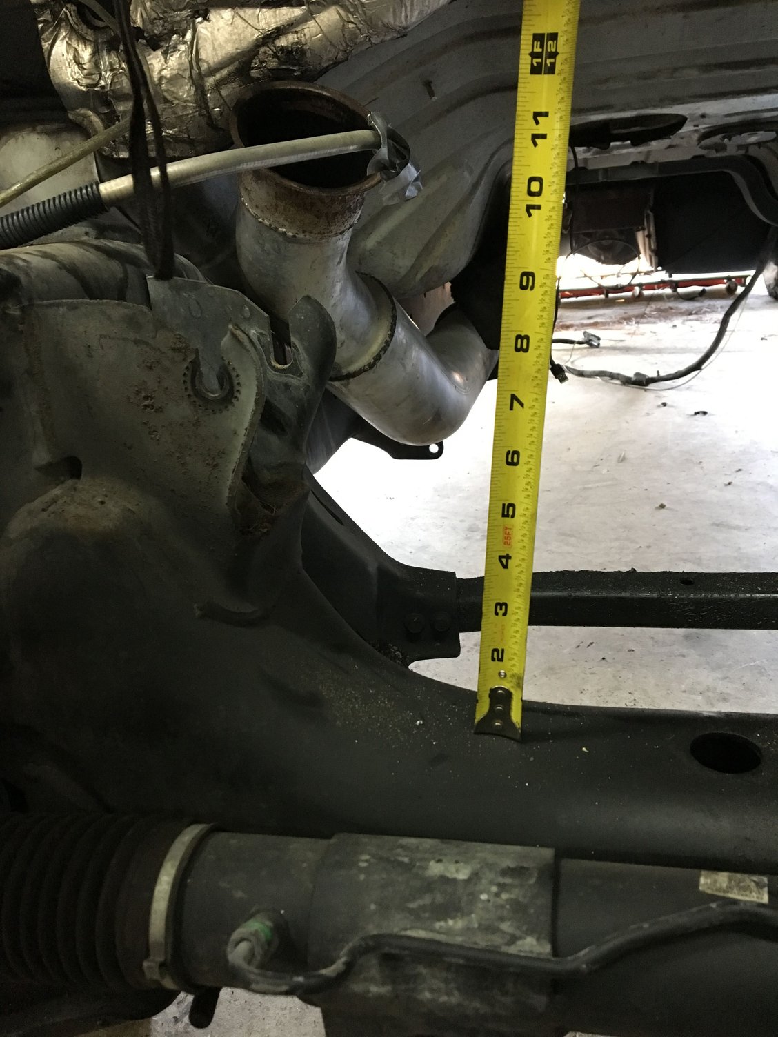

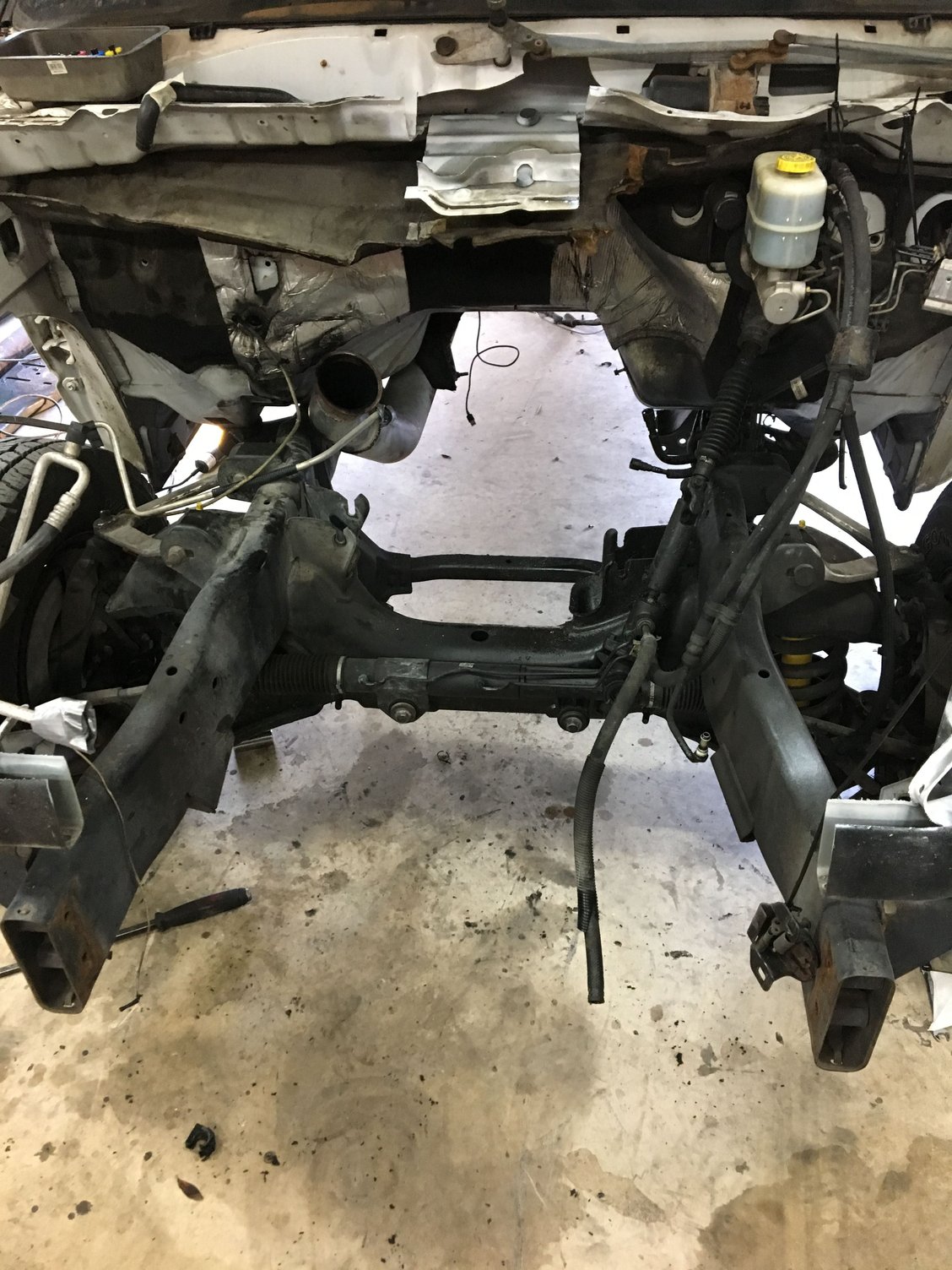

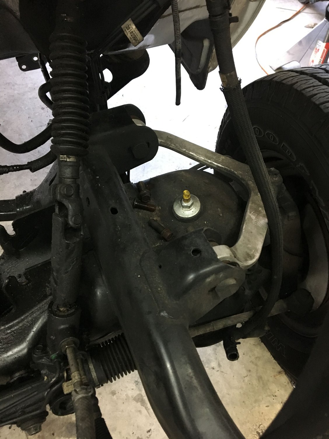

2x4 pics

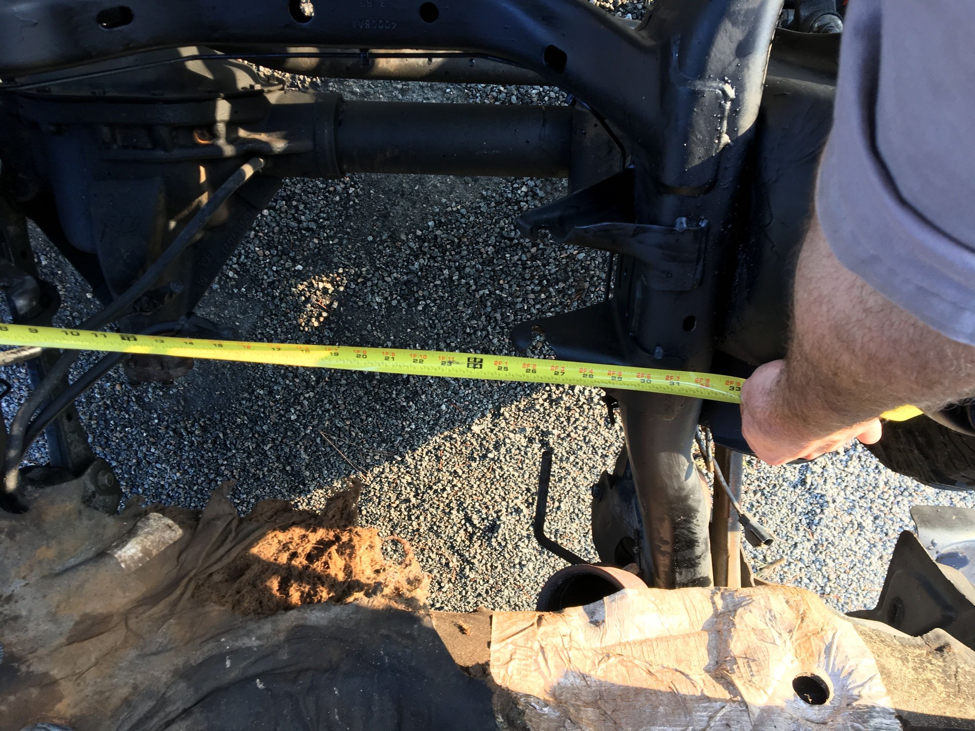

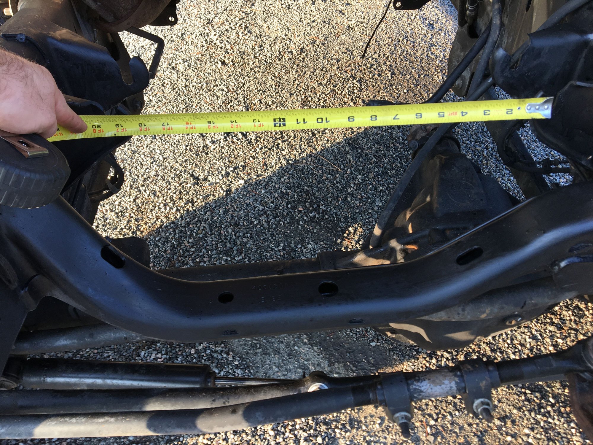

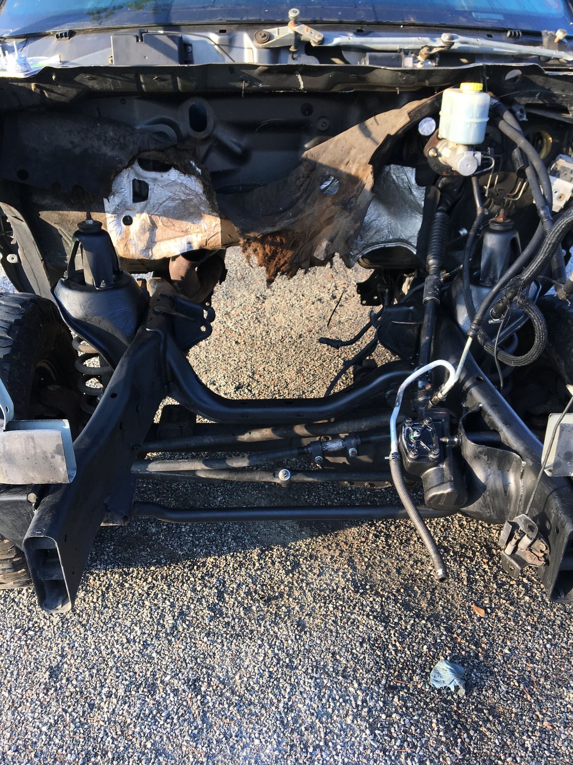

4x4 pics

Hopefully this helps
Hopefully this helps some poor bastard that wants to swap their 2x4 to 4x4 Cummins
a 3” lift should allow engine removal without taking apart the engine
i unbolted the cab and jacked up the cab a few inches to allow the whole engine to slide in TIGHTLY!
Any questions??? Feel free to ask!
Ive had an 03, 04.5 and 05.5 engine in and out and don’t mind helping anyone like I said spread the pictures so everyone can know!
thanks and God bless!
