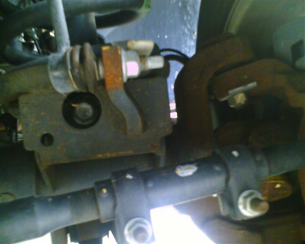

here are some better pics. the one that looks twisted is the drivers side, and the one that is straight is the passengers. is the drivers side supposed to be crooked.
If this is the sway bar what the hell is the trac bar then?!
sorry guys i am a newbie to SFA so i am trying to understand everything, you just have to tell me once though!

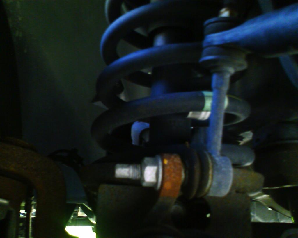

other pic............drivers side

i think i figured it out, the track bar runs paraell to the axle and is right above it. i am correct???!!!
Old Mar 28, 2007 | 05:54 PM
  #64
ptgarcia's Avatar
Posts: 5,777
From: Alta Loma, CA
Yes. The passenger's side mounts to the axle and the driver's side mounts to the frame.

Hey guys in inspecting my front end i saw the where the track bar connects on the drivers side looks differnt from the passengers side. see pictures, does this look bad?
Should i take this to the dealer? Is anyone elses like this?? just wondering if this is a problem and its going to wear the parts out prematurely...
Like I said before, its on a ball and socket, won't hurt anything being a little cocked, but grab it with some pliers and turn it if it bothers you. I wouldn't take it to the dealer with something as trivial as that...
you think pliers will be able to move it? i will have to try.
