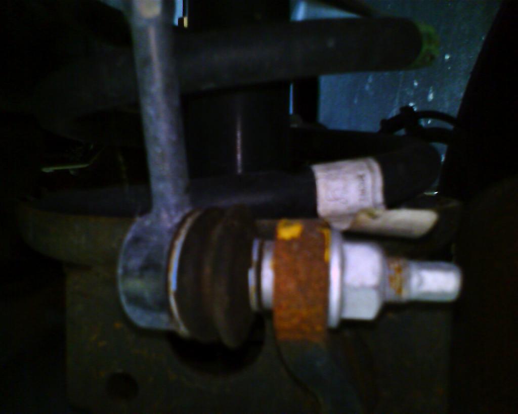

Hey guys in inspecting my front end i saw the where the track bar connects on the drivers side looks differnt from the passengers side. see pictures, does this look bad?

The picture above is blurry and I can't tell what I'm looking at.

I believe it is where the trac bar connects on the driver side. if yall still cant tell i will take a better picture when i get home.

Thats the left side sway bar link, looks normal to me, just a little twisted, but its a ball and socket design, so it's allowed to twist.
