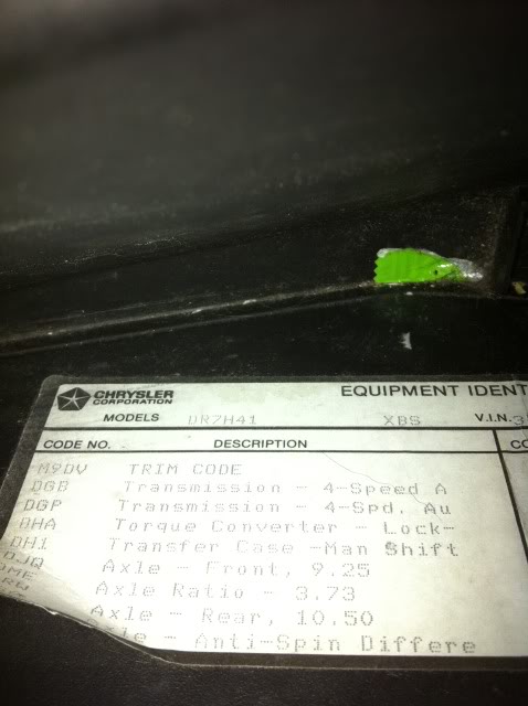

Well I've got both tranny codes I guess? The shop said for sure I have a 48RE as the harness is different between the 47 and 48. Here's a pic of the tranny codes:

I'm so confused!!!!!!!!!!!!

according to the VIN you sent me you have a 47RE NOT a 48RE
They are blowing smoke, no differences in the harnesses between an early 47RE and 48RE. The 05 and up trucks have differences but not the 03's.
You can tell the 47 and 48 apart by looking at the tip of the input shaft. If they are basing their opinions on the external factors I would seriously question their building abilities.

Well my sticker shows two codes and now I'm thinking I got hosed from the tranny shop.

I just wanted to make sure I wasn't getting charged for a 48 if they put in a 47! Anyway, I went back to the shop today and they proved to me, it is in fact a 48RE!!! And yes they are giving me a 100,000/3 year warranty.
Thanks to cbrahs for helping me out and getting me a build sheet!!
