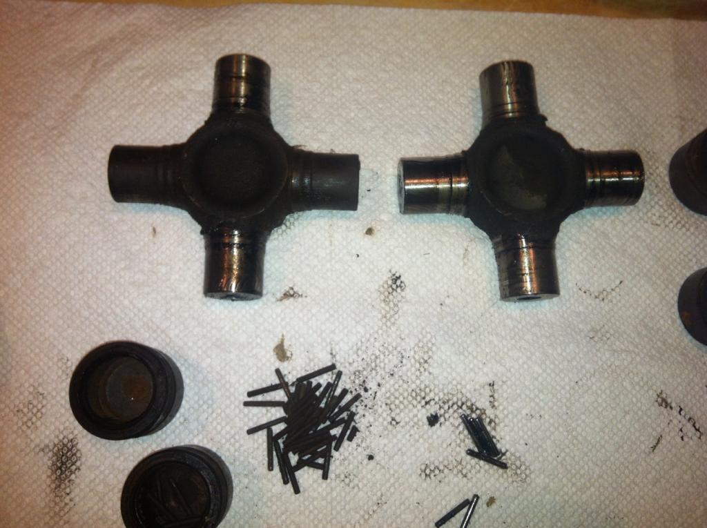

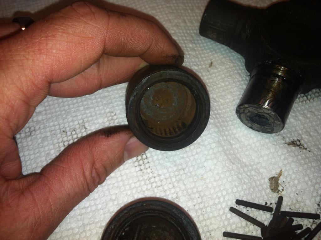

Right front axle U-joint went bad...Spent all day yesterday and part of today changing both sides out...The right side was an absolute PITA...It took about 4 hours for disassembly and a solid 2 hours of that was just removing the hub. Everything was rusted up good and tight. The left side wasnt half as bad. Even after a good scrubbing and cleaning, reassembly of the right side was tough...As far as the u-joints themselves, well, I BROKE a 6-inch bench vise trying to press them out. Snapped it in half. Ended up using a 20 ton arbor press to break the u-joints out of the yokes. And by break I mean explosive seperation. Those things were rough.
Here are pics of the bad joint, note the needles still in one cup, rusted together and seized in...This is what factory sealed junk ends up looking like.

When they start coating your front wheels with rust dust, they are done. I replaced my original joints at 96k with greasable precision 464. My rear driveshaft joints were done at 133k and replaced with precision 330a.

I never noticed any rust on the wheels, I first had a squeak/creak when turning. That disappeared and along came the rhythmic knock. Once I got under there and spun things around it was quite clear that the joint was bad...
I also used the Precisions, glad to know youve had good luck with them. The process of doing these isnt complicated, but it is heavy work. And the rust factor had stuff so seized up it was a real effort to get the job done....

I just did my left side this weekend. They were both replaced about 120,000 miles ago with the Precisions. They do have the grease fittings, but one cup would not take grease. Lack of grease in that cup lead to siezure.
Guess I can't be to upset, truck now has 190,000 miles on it.
