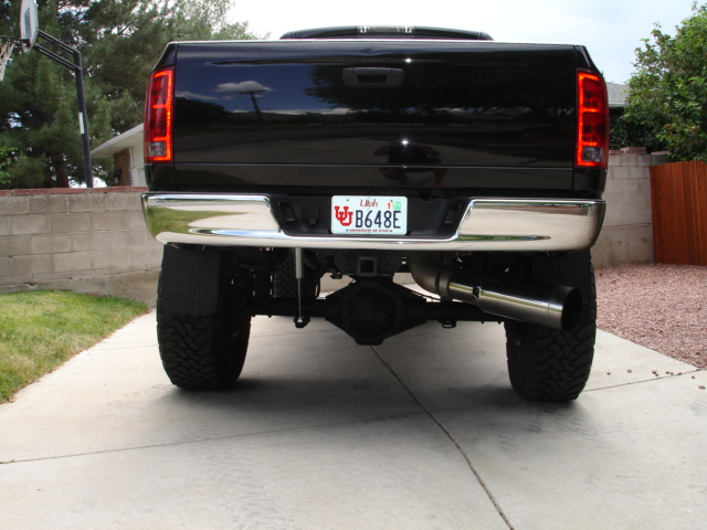

Hey guys first post...........My trans in the summer (97 degrees) likes to climb up to about 220 in traffic. I have a full built trans and converter. Trans shop says its normal as long as it doesnt climb past 235 or so. What do you guys think?

Never mind, just found the problem I think.......temp sensor is about 6 inches from the 5" exaust, going into the MAGTEC pan. Im sure that would put me 10 to 15 degrees higher

if that is the case, keep the sensor in that spot, get some 2" exhaust heat wrap and wrap that section of the exhaust. problem solved
