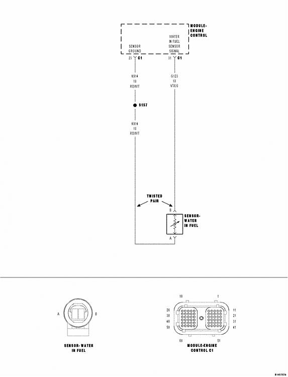

Here is a pic of the water in fuel sensor. Try unpluggin it and see if the light goes out or the code goes away. Then see if the engine runs better. The sensor may have gone bad.
Water-In-Fuel (WIF) Sensor Replacement: The WIF sensor is located on the side of the fuel filter housing (FILTER HOUSING).
Disconnect electrical connector at sensor.
Clean area around sensor.
Remove sensor by rotating counter-clockwise.
Check condition of sensor o-ring. Replace if damaged.
1 - FILTER HOUSING
2 - FUEL HEATER AND THERMOSTAT
3 - FUEL HEATER MOUNTING SCREWS
4 - FUEL HEATER ELEC. CONNECTOR
5 - WIF SENSOR
6 - WIF SENSOR ELEC. CONNECTOR
7 - DRAIN HOSE
8 - DRAIN VALVE MOUNTING SCREWS
9 - DRAIN VALVE

P2269-WATER IN FUEL (WIF)
For a complete wiring diagram Refer to Section 8W.
When Monitored:
Ignition on.
Set Condition:
Low voltage detected at the WIF signal circuit at the ECM.
Possible Causes
OTHER DTC'S PRESENT
WATER IN FUEL
ECM
INTERMITTENT CONDITION
Always perform the Pre-Diagnostic Troubleshooting procedure before proceeding. (Refer to 9 - ENGINE - DIAGNOSIS AND TESTING)
Diagnostic Test
1. OTHER DTC'S PRESENT
With the scan tool, read DTCs.
Do you have any additional water in fuel DTC's?
Yes
Repair other Water in fuel sensor DTC's first.
Perform POWERTRAIN VERIFICATION TEST VER - 1 (DIESEL). (Refer to 8 - ELECTRICAL/ELECTRONIC CONTROL MODULES/ENGINE CONTROL MODULE - DIAGNOSIS AND TESTING)
No
Go To 2
2. WATER IN FUEL
Using the service publications as a guide, drain the water in fuel separator.
Did the DTC become inactive after draining the water in fuel separator?
Yes
Clear DTC, repair complete.
No
Go To 3

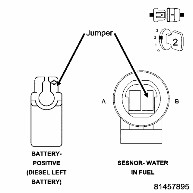

3. ECM
Disconnect the WIF sensor harness connector.
NOTE: Check connectors - Clean/repair as necessary.
Using the scan tool, monitor for DTC's while connecting a jumper wire between the (G123) signal circuit of the water in fuel sensor and battery voltage.
Did the water in fuel light go out?
Yes
Refer to the INTERMITTENT CONDITION Symptom (Diagnostic Procedure). (Refer to 9 - ENGINE - DIAGNOSIS AND TESTING)
No
Replace and program the ECM in accordance with the Service Information.

3. ECM
Yes
No
Wow, thats alot of info, I am definetly having defueling, that may actually be my whole problem, I unplugged the sensor yesterday to make sure it was connecting good, but that was it, tomorro wbefore I take it in I will remove it and make sure it looks good and clean, maybe it has some rust in it from my little incident.
Thanks alot for your time Vz dude.
