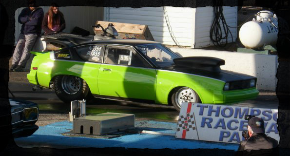

Nick...the trans seems fine..and once again I was told it had recently been gone through with a new converter when I bought it. CAC?...a bit of help with what that is please..lol I'm use to working on this and it's not diesel
