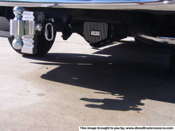

I have thought of an oil cooler for the rear diff. I know somewhere on the cover there is enough oil preasure caused by the gears at highway speeds to move the oil through a cooler then returned at the top of the cover. But I just took the easy road and bought a Mag-hytec. Full syn Red Line here.

I really like the mag h rear cover. extra capacity and it looks good and makes maint less messy. the temp gun is a good idea i'll try that when i pull a boat this summer. and yes the factory fill in my rear diff looked like a milky mess when i drained it too. i refilled with mobile 1 syn.

Mine did it also so this is what I did to make sure it never happened again.
