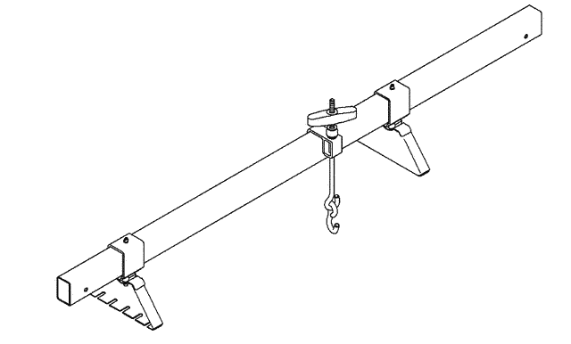

It can be done let me know how it works out for you. You can fabricate engine support fixture
REMOVAL
4x4
1.Open the hood.
2.Disconnect the battery negative cables.
3.Remove the intake air assembly.
4. Remove the radiator shroud retaining bolts.
5.Install engine support fixture # 8534B.
6.Raise and support the vehicle.
WARNING: HOT OIL CAN CAUSE PERSONAL INJURY.
7.Drain the engine oil (Refer to 9 - ENGINE/LUBRICATION/OIL - STANDARD PROCEDURE).
8. Loosen the front engine mount bolts.
9.Lower the vehicle.
10.Use the engine support fixture #8534B to raise engine out of the front mounts.
