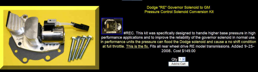

What accessories? If you are grounded gound, not overtaxing the electrical system, and have now scuff wires that sounds far fetched.
For a heavier duty solution here is the only one I have found.

I do have alot of stuff in my truck, I have a cb, invertor for my laptop, gps. I have found a conversion to a gm solenoid that is supposed to be heavy duty but I would like to find someone who has used one first.
