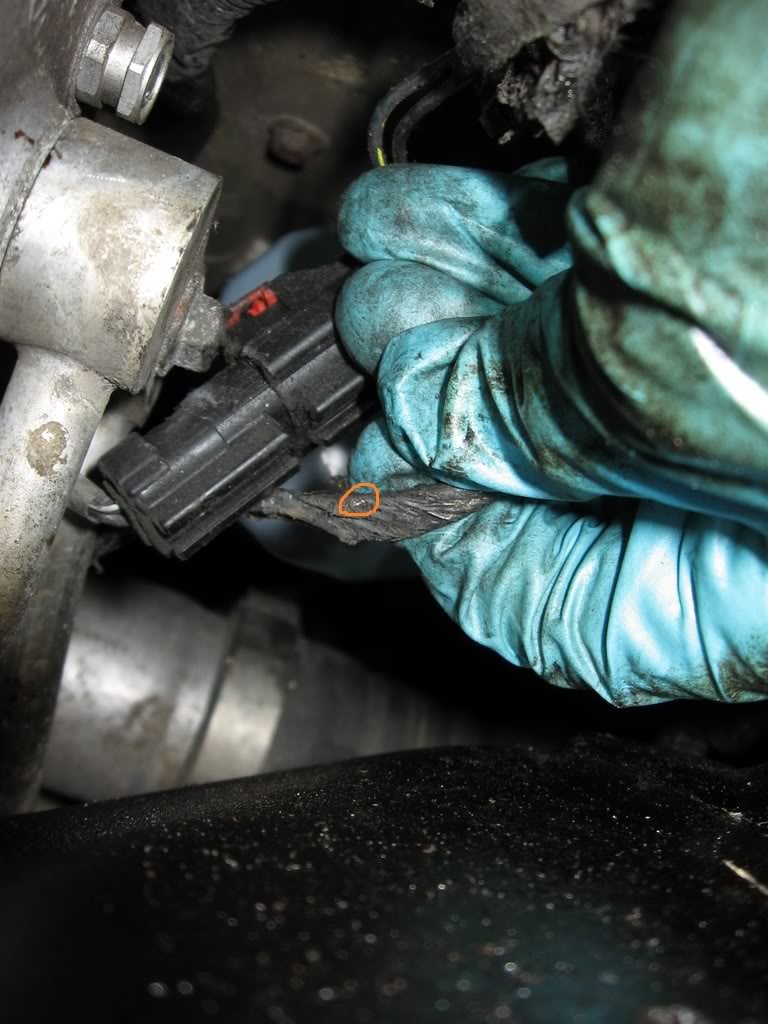

Check the wiring up around the ac compressor. They're know to rub on one of the ac lines and cause a short. All kinds of wacky things will happen.

Given that before the engine was perfect before being R&R'd, and that the injectors were fully bench tested not long before the O/H, and the engine did not exhibit this tendency before, I am inclined to think something the shop did may have changed something (chaffed wiring as suggested or something related to to the recent work) if only because there are few coincidences in life. In the street, I tried manipulating wiring bundles, but I couldn't closely examine them. Tomorrow!
