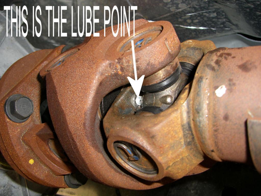

FYI Jim,
That fitting is a real Bi*** for many people, including me.
There are a number of threads on it but most use this pic to help find it.

Hey thanks for the pic. I don't think I would have found it!
