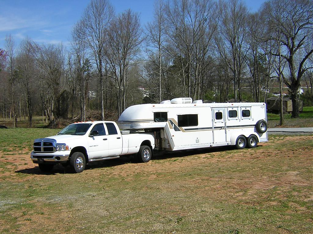

Such a big differance in models/years. Pulling 8k plus max egt for me is about 1150 and you gotta work it to get that.It takes a LOT for me to hit 1200 towing.
