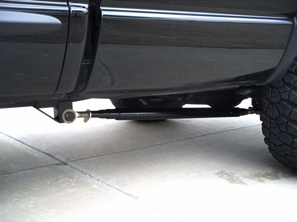

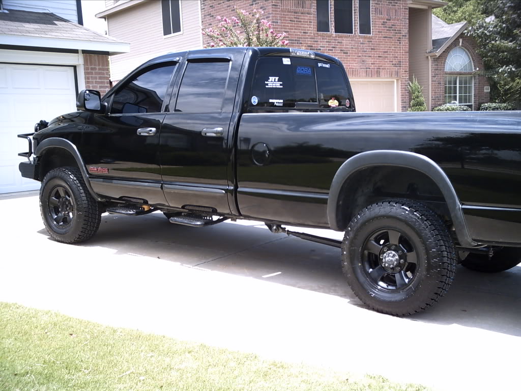

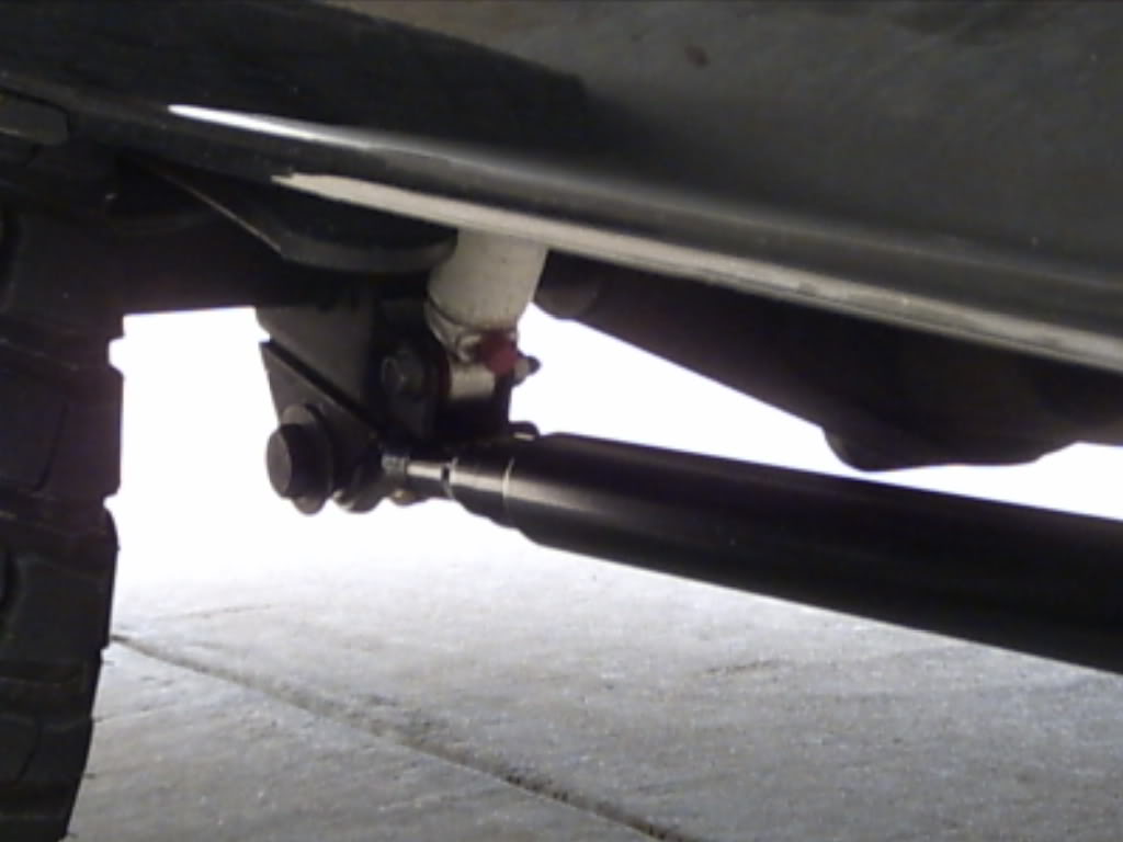

I drive my truck every day with my Lazarsmith Traction Bars. Don't know if this is what you are looking for. I like them alot. Puts the power to the ground and eliminated any axle wrap. There was a video of my truck on dyno with the rear wheels moving forward maybe an inch or more...but I can't locate it now. But the axle doesn't move now.
I use my truck for daily driving (117K currently), towing my toyhauler, occasional drag race and sled pull. The traction bars do nothing but help any of the above as far as im concerned. Hope that helps.
