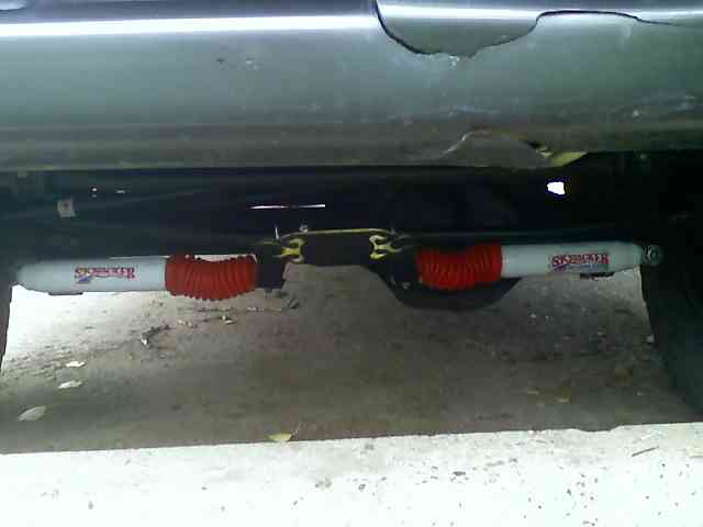

HEy, lots of replys holly...... anyways my story, went in for another aliment at Kal tire Upper and lower ball joints were gone, and the front Steering rod all on the right side, I rotated my tires and haven't done it sence even with the quad in the back, ive tryed to get it to do it again but nothing.... my Brother said that it could have been a broken belt in one of the front tires, witch i could see that being the problem!... 1800$ in front end parts later, shes back to normal... Next investment iam going for Dick Cepek tires 33 12.5 17
Old Jun 25, 2007 | 06:25 PM
  #50
vj_M's Avatar
Posts: 348
From: Alberta
heres what i put on..
Death Wobbles or not... Dual stabilizers are the $hit!!!! Deffently worth the investment!! even on a stock truck!
