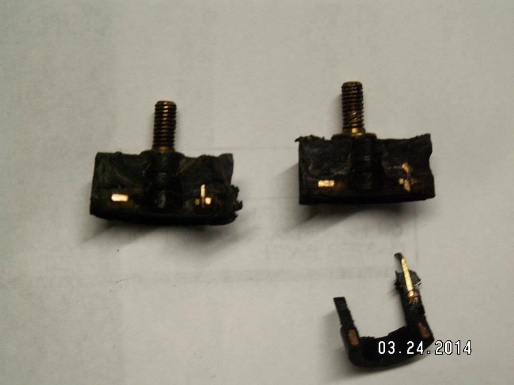

it is very easy to just change the solenoid and not have to remove the injector. i think most people are using a deep 1 1/8 socket, i used one size smaller and a dremel tool to make the socket fit perfect but we run a fleet and have changed several of them. go to ebay, there are two vendors selling them. the problem is a bad design where the coil connects to a ring by press fit during build. no new ones have failed so i think they may have it fixed.

So should i just change the solenoid or the enitre injector?
