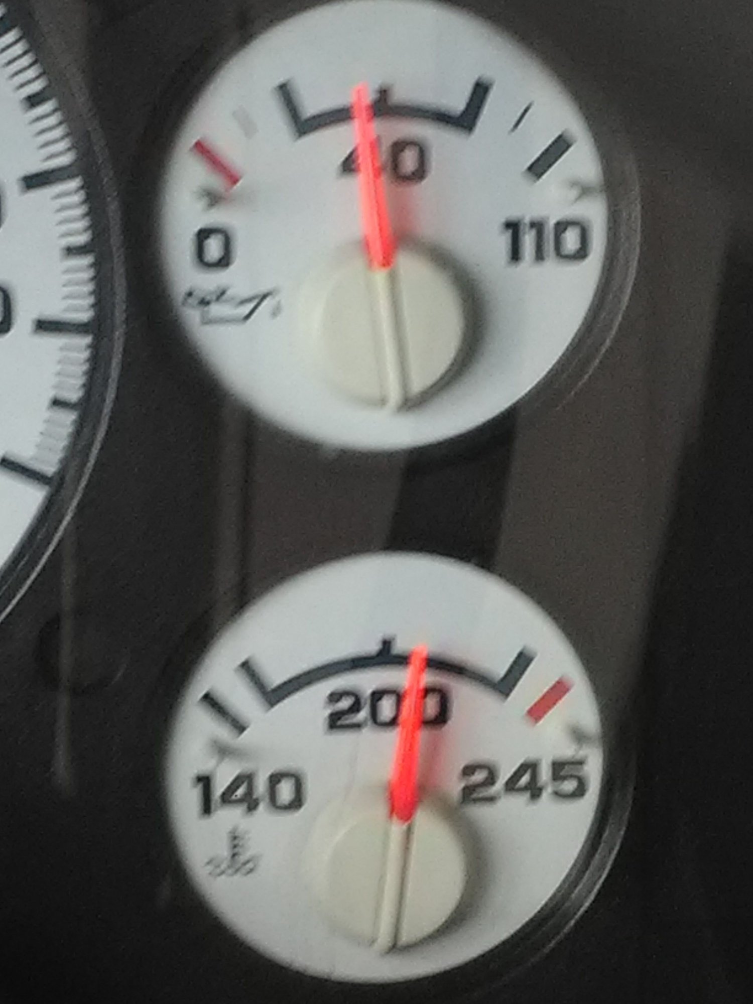

Took it to shop, the computer says the fan is locked in 99% at idle. Just realized that 30 minutes just gets it to normal operating temp, the gauge shot above was after a detour so more than 30. Replaced the water pump this afternoon, 3 years old, seems to be better ran it for a while, even put it in 1(auto and ran at 1800 RPM) for a mile or so and it only got a needle above 200. Since the fan is ? brand I do not hear it kick on. Is it normal at idle with the air conditioner on for the AC to kick in and out?
Old Jul 8, 2016 | 09:39 PM
Dynocon's Avatar
Posts: 487
From: Ohio
Does the above photo seem to hot? It have never been that high, why is red line is 245?
My normal has never been a needle thickness over 200 and only for a minute.
Old Jul 9, 2016 | 05:06 AM
gcssr's Avatar
Joined: Jan 2003
Posts: 414
Likes: 7
From: new braunfels, tx 78130
when was the last time the tranny was serviced, as the bands and clutches wear there is more slippage, which in turn heats the fluid, causing temps to rise, around 50 the tc locks up below that as U speed up U notice the RPM follows the throttle, indicating the clutches are slipping, some slippage is normal, but as bands and clutch pack wear the slippage get greater, causing fluid to get hotter, only a question, but may help.;;
Old Jul 9, 2016 | 06:06 AM
Dynocon's Avatar
Posts: 487
From: Ohio
The tranny was re-built maybe 10k ago. Now with the fan/thermostat/water pump changed is this the new normal?
Old Jul 9, 2016 | 06:48 AM
Dynocon's Avatar
Posts: 487
From: Ohio
The old water pump looked fine, fins were OK, impeller seamed tight on the shaft. Could the pump be bad?
