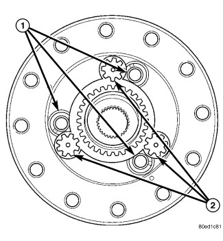

All diesel Dodge truck since 2003 have been using American Axle diffs. The only truck that were not are the 1500 Ram. Trac-Rite diffs function as a limited slip.
When one wheel begins to spin the pinion gears (2) on that side, are forced toward the pinion brake shoes (1). The pinion brake shoes then cause frictional drag on the opposite pinion gears and the side gear. These friction forces transfer the power to the opposite wheel. Once the frictional forces are overcome, differentiation will occur. The torque will be continually biased by the frictional forces to the high traction wheel.
