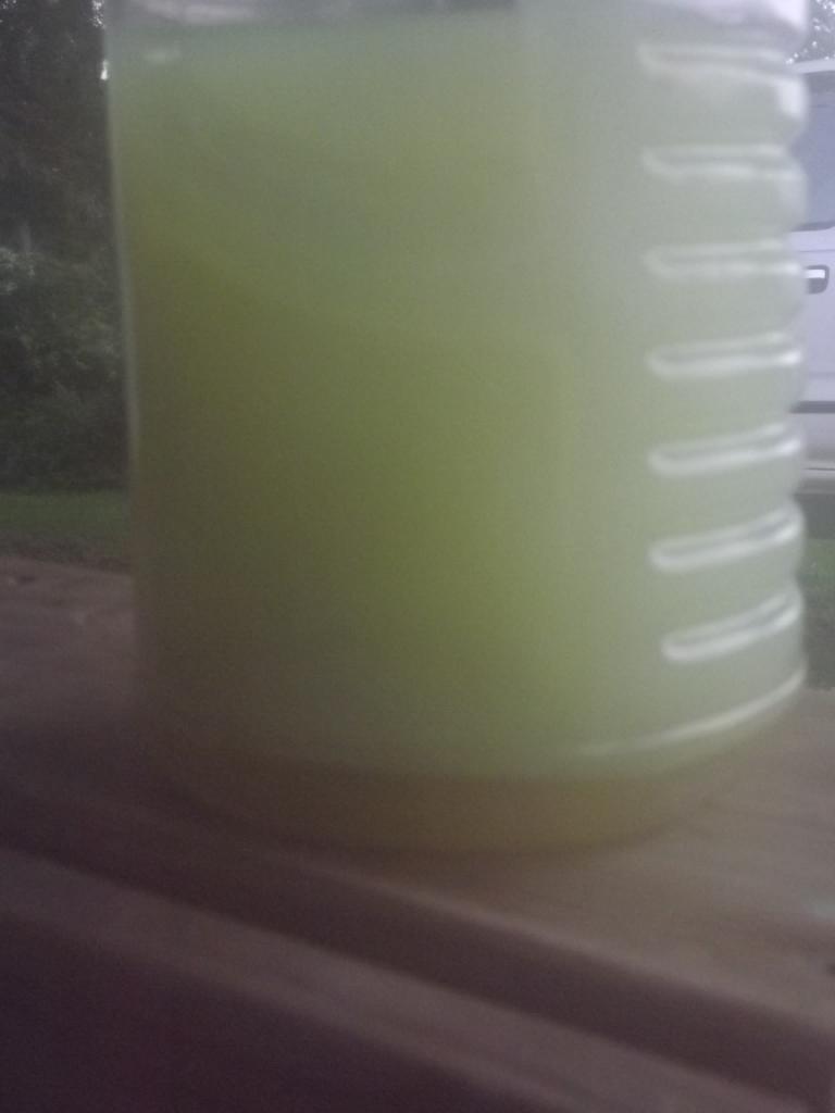

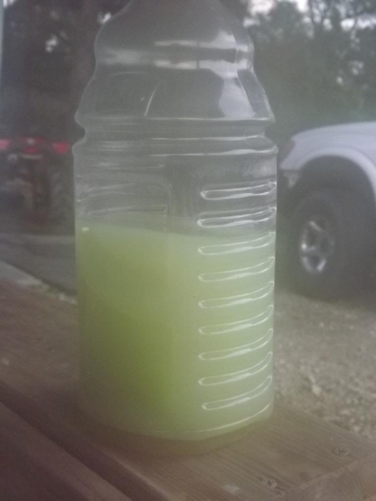

Well I left from my house just put a new FCA valve in had a 1/4 tank of fuel truck ran fine. Went got my truck inspected then went to fill it up were I have for years at Valero never had a problem with there fuel they have a high volumn of fuel run through this station. I fill it up 22 gallons start truck and fuel gauge reads empty its done this one time before no big deal get home turn it off and then back on usually fuel gauge will jump right back up.No go this time. Get up this morning go to crank it it fires up then it is rattling big time shut it off try it again does same thing. I then proceed to pull codes first one was P0463 then P0462 then P0088. I then drain fuel out of filter housing it looked like a combination of Mountain Dew color and Milk(CLOUDY) to me. I look at the jug its got about 3 ounces of water in the bottom of the clear 2 Qt. jug.
My question will this throw these codes. Also no WIF light came on at all.
Any help on this will be much appreciated. Do I need to drain this whole tank of fuel ? Could i possible make the fuel station pay for this. I also just put in new Injectors at a cost of about $2800 I know i will change the fuel filter for sure. Sorry for the long post but I wanted ya'll to know whats going on and seek some help here.

That's some nasty looking stuff for sure. Try to find a fuel additive that will emulsify the water and maybe the water separator can pull it out. Other than that, change the filter often until the fuel is gone, or drain the tank. Very doubtful the station will pay for it. I've never had good luck with the Valero station here by me.....lot's of water in the fuel the times I've purchased there.
The water is very detrimental to the injectors.....no bueno for sure!!!

Did you get a receipt? If so I would at least try to get a refund on the fuel. Show them your samples.
Then I would go drain it completely! I would not try to run anything else in there. Change the filter like you said and then even run about a quart of 2 stroke oil with the fresh fuel.
