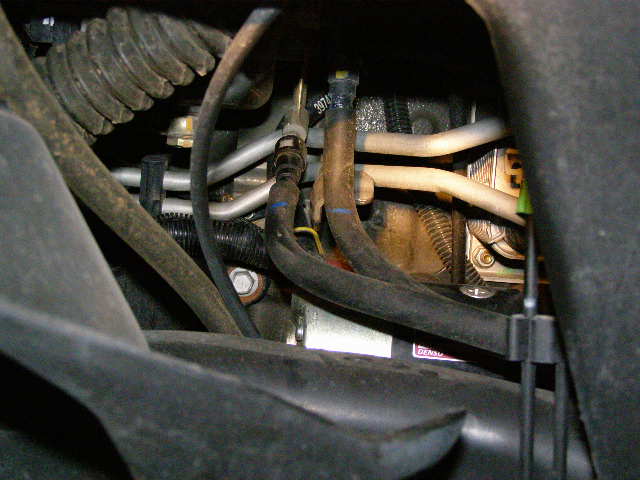

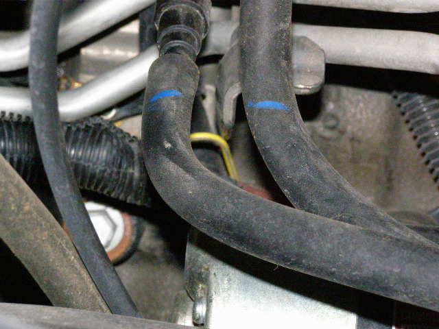

It's probably the yellow wire by the starter shorting out. They often come from the factory with the yellow wire rubbing up against a metal bracket. Once the wire coating wears off it starts to short out and cause a no-start condition. I bet that's your problem.

I would wager a large sum of money on that wire being your problem.
Here's a couple of pics posted last year by another member...

You don't have to touch the starter. Just go outside and look for that yellow wire. When you find it just bend the wire away from that metal bracket.
