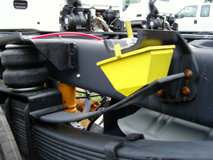

Old Jun 21, 2010 | 02:31 PM
  #57
ib516's Avatar
Joined: Sep 2005
Posts: 520
From: Sask, Canada
Originally Posted by J BODY
I'm just wondering, and thinking out loud about another 3500 mega that I know has this issue, that if a guy were to get an extended bump stops for the overload springs on the single wheel 3500 if that wouldn't stiffen things up enough. The 3500 has the bump stop mounts on the frame, but sit awfully high in comparison to the older BE body trucks (2nd gen). The 2500 has no bump stops, or overload springs. We noticed this while looking at different builds on the lot. We also noted that the 03 3500 seemed to have a different spring configuration all together. Looked to be much more "heavy duty".
I know this is an old topic, I found it using the search feature looking for info on lauch shudder. Just as an FYI to J-BODY'S post here, I have added this exact thing to my truck (overload spring frame perch extensions called Torklift Stable loads) and I still ahev launch shudder. I know for a fact that the overload springs are in play when my 5er is hitched up. It weighs about 11500#.
Here is a picture of the stable loads (in yellow).
Here is my truck and 5er:
