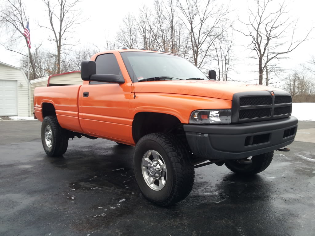

2" front spacer, running 315/70-17s on 3rd gen wheels with 1.5" spacers. No rubbing at all
