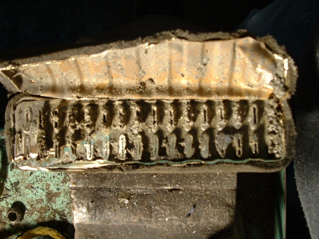

Plugged heater core.
This is the bottom cut open.
Attached Thumbnails Quick way to change heatrer core(2-3hours)-heater-core-2-.jpg
