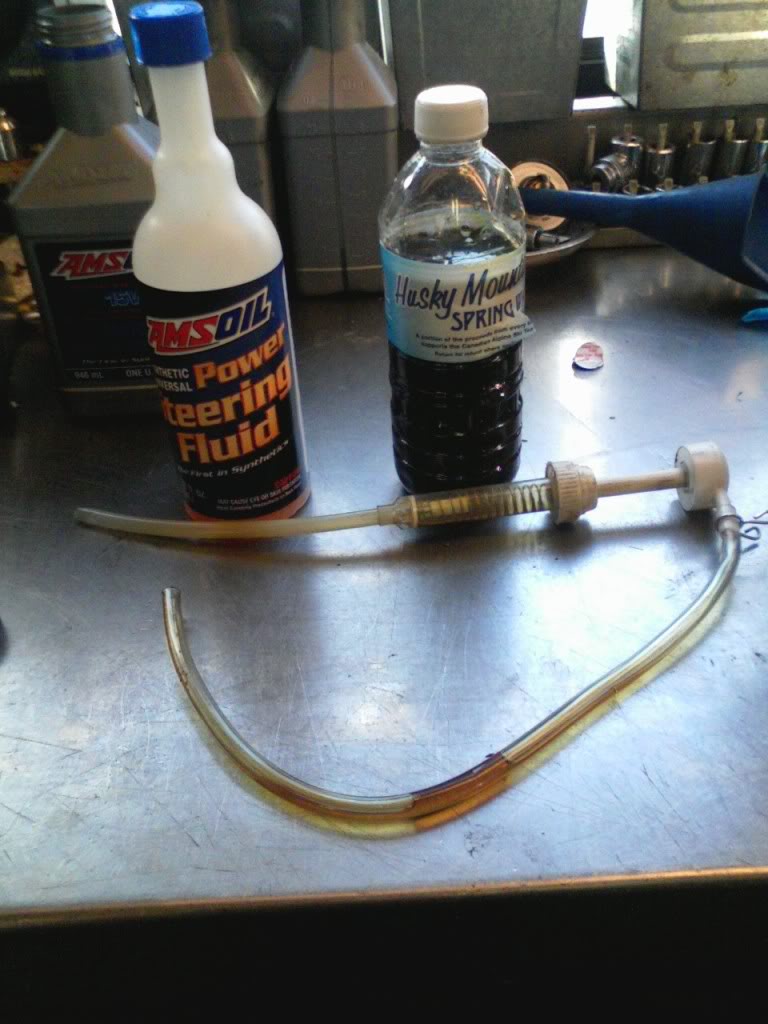

if it over flows the resivor, it is likely a failed acculimator in the hydroboost, Generally if you suck out the old fluid and fill with synethic PS fluid this condition will go away, if it does not you may need a HB
a hand soap pump works best as the straw can be sent to the bottom of the pump, with this I can get a full bottle out
