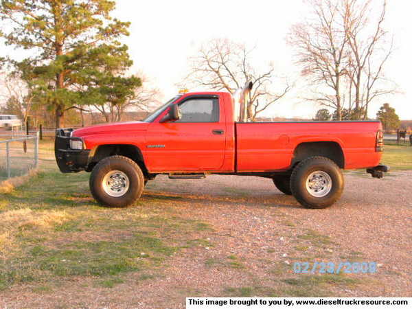

When i put my 37's on, my dad and i rigged an adjustable lift kit of sorts. Well as luck would have it after about 3 weeks I hit a pothole and broke our invention in half on the drivers side. The tire doesnt rub unless i am at full lock and hit a bump but i want to get it up a bit just for grins. So now i have a little cash and have been searching ebay for a leveling kit. I want to lift it enought to clear the tires well, but not so much that it takes my truck beyond level. I would like it to be a little less than level just because i tow and i dont like a squatty truck. I have found some 1.5" spacers and some 2" spacers im just not sure which would work best for my situation. I am pretty sure that the 1.5" spacer would allow plenty of clearance but would hate to get it and it isnt enough. Yet im also worried that 2" my be to much. My truck is still stock ride height so im hoping someones experiences with leveling kits will help me out with my decision.

1.5" should be slightly less than level. 2" is about level. I have never seen a real 37" tire with only a leveling kit. Got any pics of that??

If you look hard enough you can see part of my home made leveling kit right above the tire. Those are 37 inch military tire. And my truck is still stock height. Look in my gallery for pics of it before i put the tires on.
