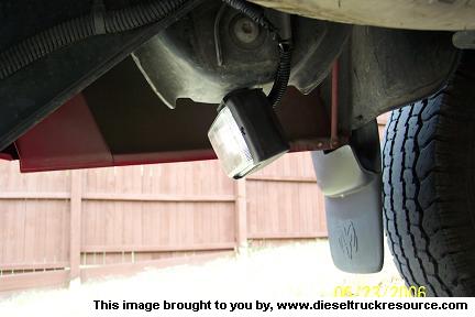

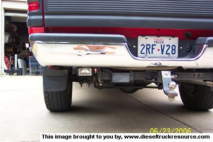

My BU light switch went out awhile back, but since they were almost worthless anyway, I haven't replaced it.
I stole this idea from another member, but I can't remember who it was. Anyway, thanks for the idea.

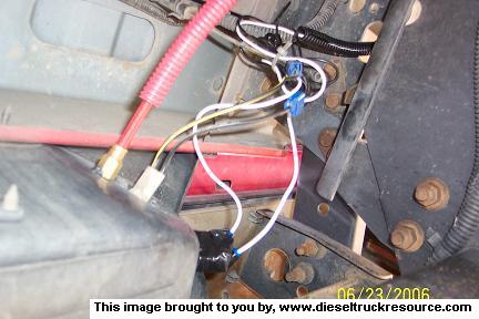

I bought the lights on sale at Harbor Freight for $8.99 and the switch and switch cover from NAPA for $15.13 total. Even if my BU lights were working, I didn't want to wire into them. I tapped into the wire that goes to the license plate light so I could either activate them with the engine and lights on or with the engine off and the park lights on.

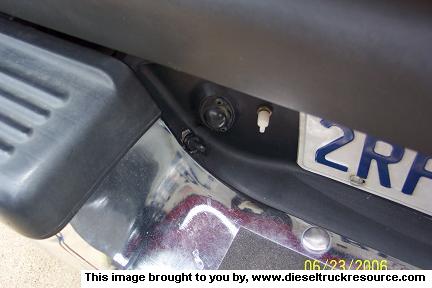

I mounted them through a hole that was already in the spring brackets. I should have ran the wires before I connected them, as I left the in-line fuse in a bit of a hard place to get to. Also, I mounted the switch with the "on" position "up" in case it accidentally got "tapped" when going over the tailgate. The ground wire in the passanger side light was getting a little hot, so I have left it unhooked for now. Not sure what is causing this......
It hasn't gotton dark yet, so I won't know for awhile how well it works.

Oh, I forgot..........Don't spend the extra money for parts from NAPA. The switch is OK, but the weatherproof cover would not seal good. I got it in place the best I could, and then put RTV around it for a better seal.

They work OK, much better the factory. But, if I was doing it again, I'd use the round "tractor" lights.

The lights (light) works pretty well from under there. I adjusted it up, and even with the one, it puts out a lot of light. I'm going to have to find a higher amp circuit before I can get them both on at the same time. I think the tractor lights will work much better........not as directional.

On yours I would recommend running a 8ga. or 10ga.wire from the battery protected with a breaker along the frame rail to the rear, or you could get power from your trailer connector charge circuit if you have one.
