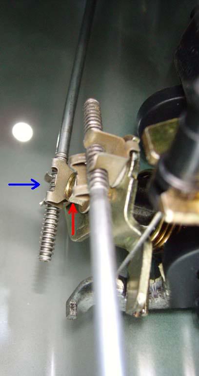

Hi dkenny, after pulling my door apart, I found the upper rod (blue arrow) needed to be shortened as you suggested. Also, the little bolt (red arrow) that holds the handle mechanism together was way too loose. It has to be a little loose or the mechanism won't work so I put threadlock on it and tightened it just enough so that it didn't bind. Those bloody plastic trim attaching barbs clips are the pits! Anyway, door handle works fine now. Thanks everyone!

great glad to hear you got it fixed..I just wish I thought about this fixed before I took off the interior panel with the door closed..either way I got mine fixed..
next time I have to look to see if mine is loose on the upper rod connection..
