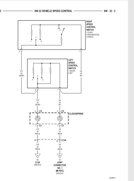

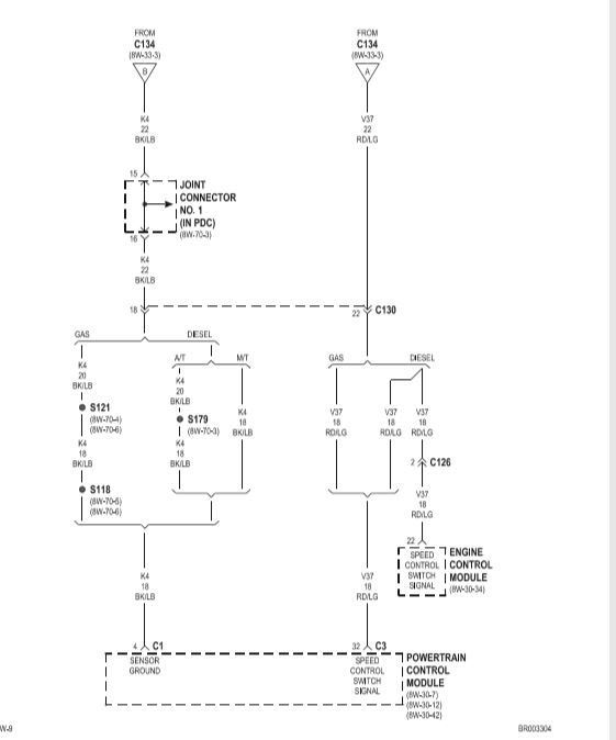

I don't know if you have the wiring, so let me post it........ I don't know why, but it put the images above.......
Thanks. Printed it out. Not sure what mechanic has. I know he checked a bunch of connections.
