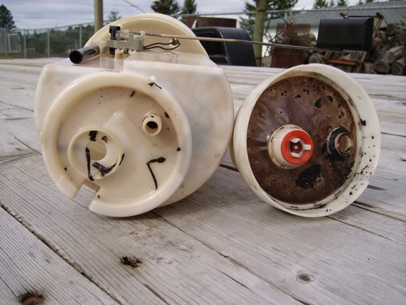

As you can see, the original unit has lots of area to catch wayward bits. The black goo in this photo is 'melted' plastic from the float.

Sounds like it might not be a huge deal to leave it in there seeing the pics of the screen on the sender unit. Thanks for all the input!
