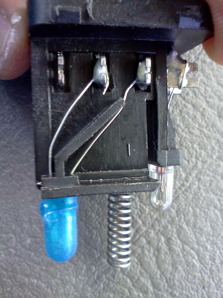

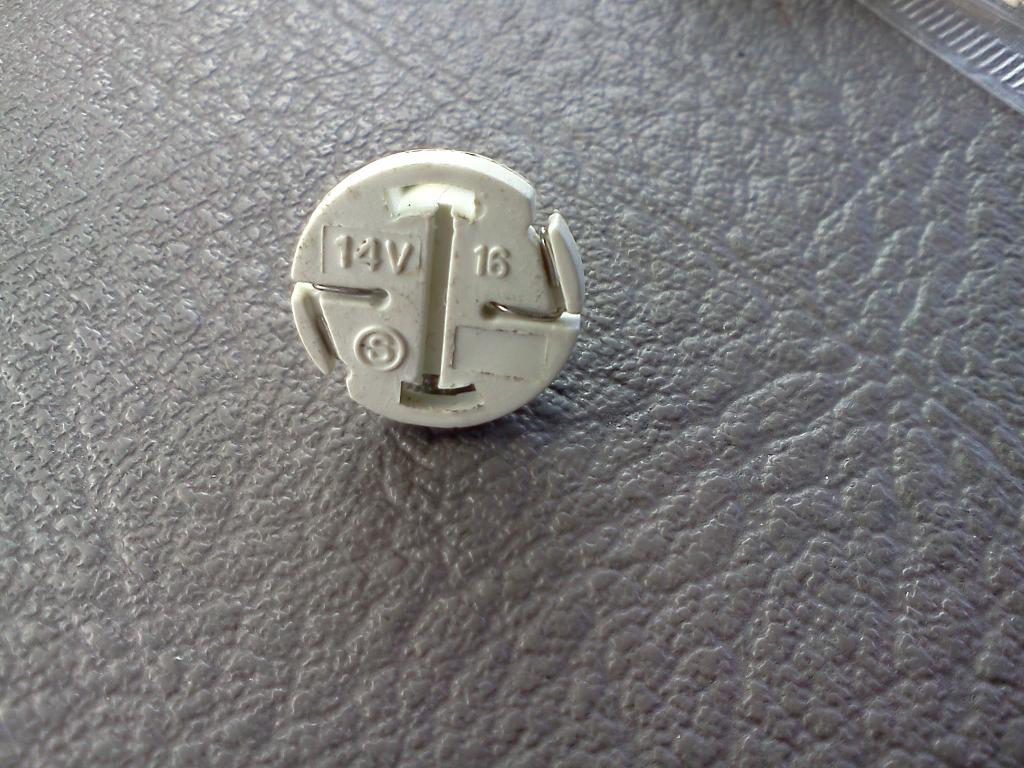

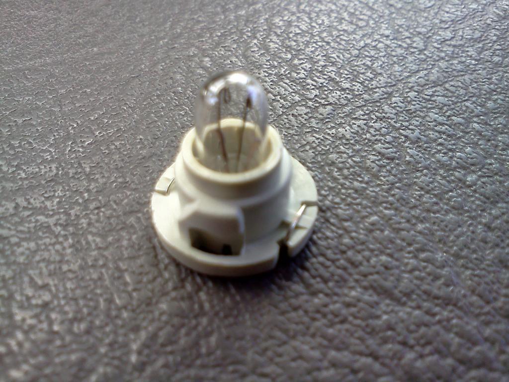

Hey guys and gals! I am needing to know where I would be able to find replacement bulbs or part numbers for the AC/Heater controller and the OD killswitch button . They both look identical to each other.

For all of you out there that are wondering what it takes. It takes a #2182 bulb.

All I know is on the button of my 95's the bulb is soldered in.

Yeah I had to unsoldered both of them to get them replaced. The bulbs I posted did the trick.

That sure looks like a dealer/replace the whole thing part.
