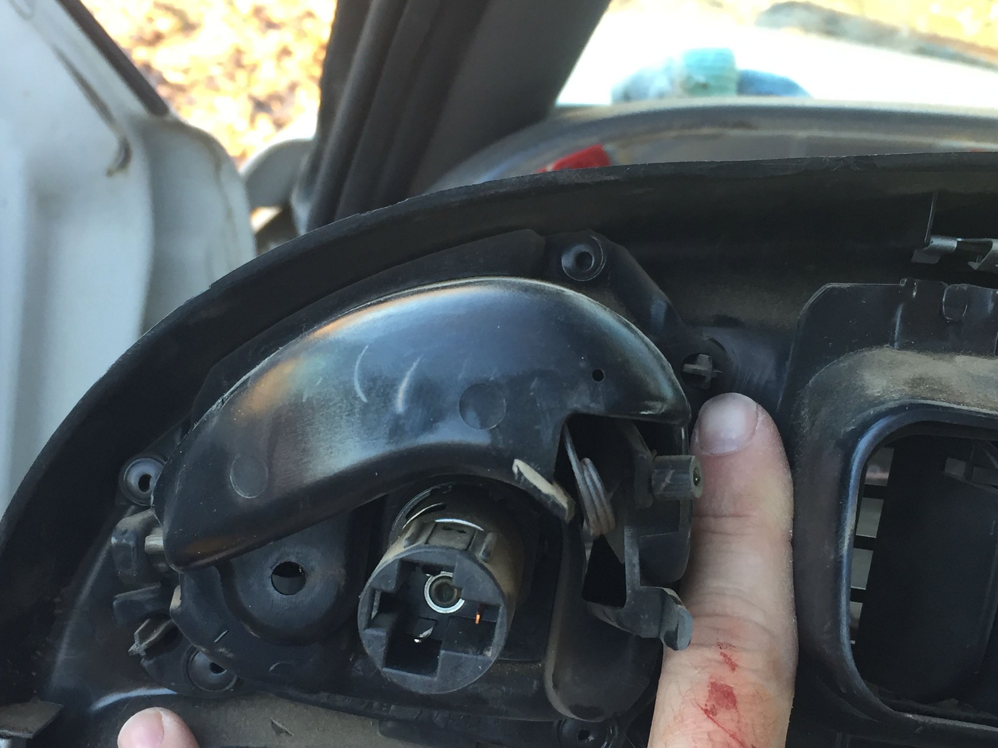

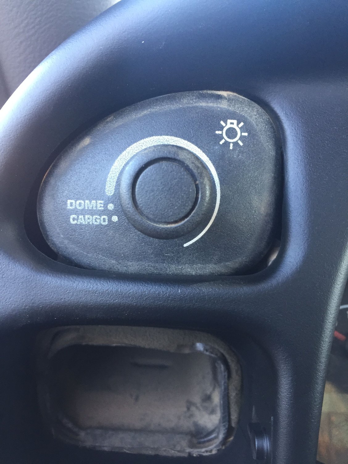

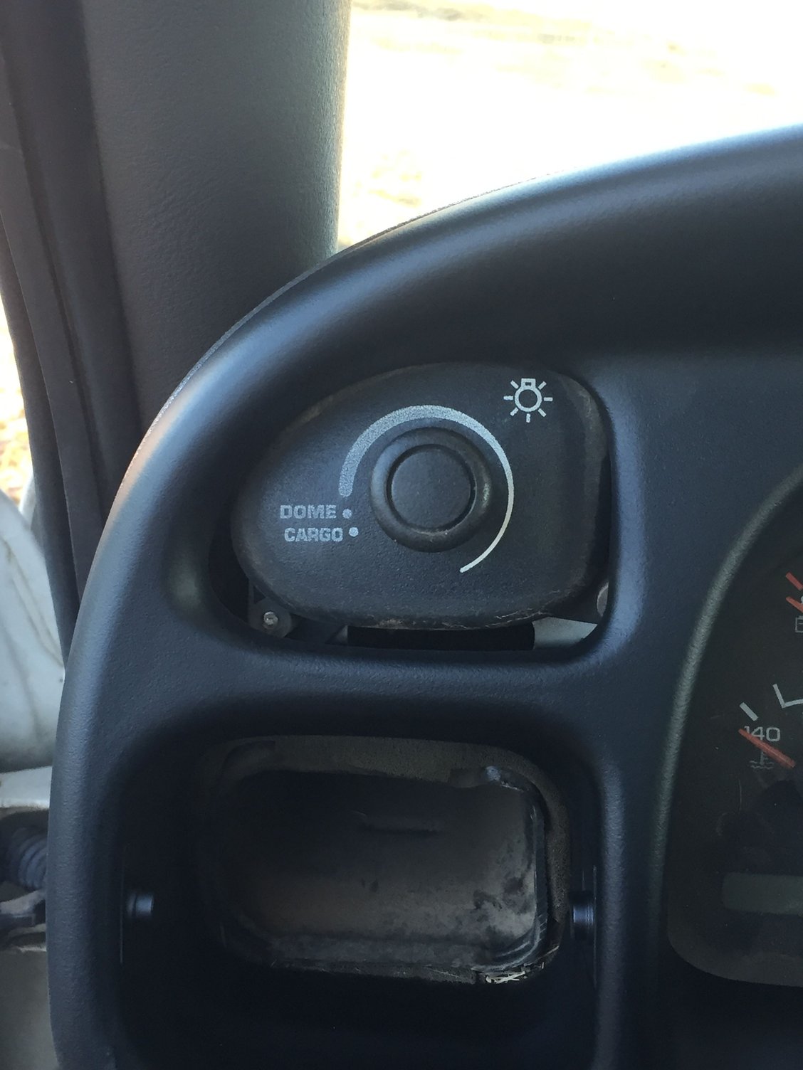

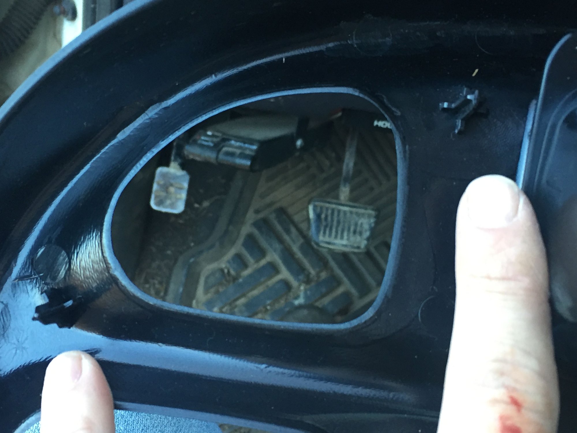

So I got my new bezel out today to compare to the old one. Geno’s was right...the headlight switch isn’t quite right. However, it looks like the 12v port and airbag switch will fit fine. The old 12v port will need to have the plastic drilled out in 4 or 5 spots where it was molded (melted) to the factory dash. Then it should be able to be removed and swapped right over to the new bezel. I’ve included pics to hopefully show what I’m talking about
Position of headlight switch with new bezel
Slightly repositioned for a better fit. 2 of the mounting tabs being broke on my dash structure is how it was able to be repositioned. If your structure isn’t broke then may have to use some sort of black material as a filler for the gaps
