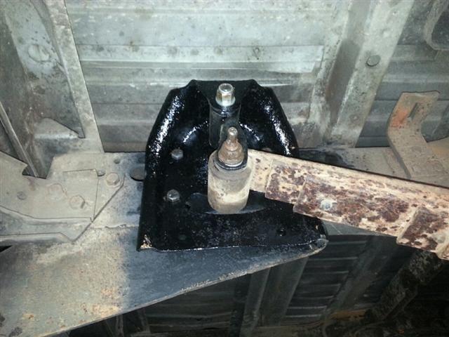

I lowered and flipped the stock stuff... when I put full 2ndgen stuff in the back of my 1stgen. Been very happy with the ride.

Lowering the front hanger (on the frame) and flipping the rear hanger makes for lift.

I suggest lowering the front hanger anyway to keep the spring level. Then your wheelbase stays the same and you don't invite strange handling when towing.
