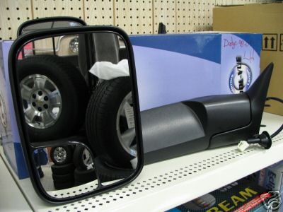

I just found a compay on the net called kool vue. They are selling 2nd gen power heated tow mirrors. They arn't mopar but they look the same and they have the plug on the wire and everything. Looks alot cheaper then getting two sets and doing the swap. To bad I allready bought two sets to swap. I wonder if the quality is as good as stock they look good to me though. Just though I'd share that.
Attached Thumbnails 02 3500 W/heated Stock Mirrors To Larger Mirrors?-mirror2.jpg
