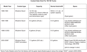

Q5: In issue 54 TDR writer Andy Redmond gave us the specifications for coolant. Could you do a reprint?
A5: You bet. Here is the TDR Issue 54, page 157, reprint:
https://www.turbodieselregister.com/...6&d=1476814774
Coolanta Data Chart - '89-'06 Dodge Turbo Diesel Trucks
Q6: Since 1989 the coolant type listed is ethylene glycol. How does ethylene glycol (EG) compare with propylene glycol (PG)?
